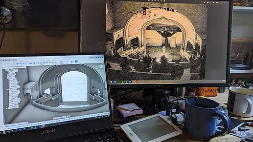

The interior is a homage to the 1907 Vancouver Pantages Theatre which was demolished in 2011, and the site, as tradition demands, was turned into condos.
I started by collecting as many photos of the Pantages as I could. This flickr page was super helpful
From the photos, and the lot dimensions I was able to approximate the size and layout of the interior. I modeled most of it in Fusion 360, and used Rhino3d for anything more artistically inclined.
Some sections, like the openings below the boxes I discovered later had different openings, and the seating layout is a complete guess, so its definitely a homage rather than an exact recreation. That said I’m pretty happy with how it turned out.
