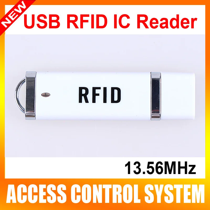

In a tangentially-related note, I wonder if one of these wold work?
@funvill: It looks to me with my very limited experience that those would both work and appears to be corroborated by this product at Adafruit using the same reader chip with more clearly-stated specs.
