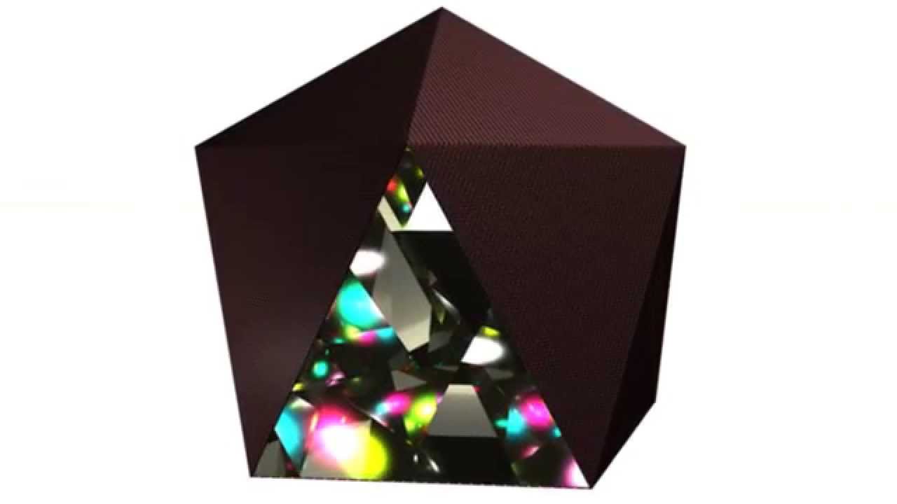

I am also looking for someone to help me render a image of the dome with the LEDS. (ray tracing) I want to show how the lights will bounce off all the walls.

Here is a rendering that @RobertButterworth made for me
it looks so pretty.
I like it. It also looks like an episode of Doctor Who, in the Tom Baker era… :smile:
