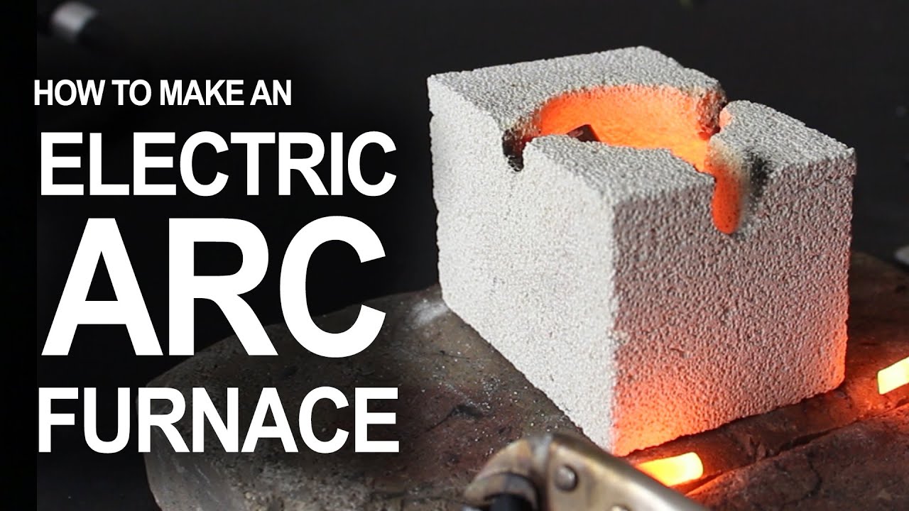

@hectorh that electric arc furnace is sweet. If I can’t find access to a furnace through ucb or other I might have to take a stab at making that…
