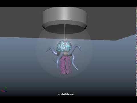

Thanks to @TimothyKonrad we have an updated visualization of Codename Squiggles!

Ya I’ll try and a bang out a 3d model for the thing
Maybe with hackspace banner or something
We also decided that it would be a lot easier and better aesthetically to not flip them upside down, but to have a closeable hole in the top for mounting on the ceiling and a hidden hole in the bottom for puppet holding and mounting at events.
Ok so I’m having trouble getting a copy of rhino to work on my computer
But I have a trial version at work so I mocked up the chassis we were talking about where to top can screw in and the bottom could be a puppet
And here’s a shot of a more complete model
I’m still working on the brain bit but we’re getting the idea right
This is all scaled and it’s a tad larger than the. Globe space so we may want to drink it

Ok a few more
Annnnddddd the sqiigs is too big in places but…
looks hilarious. luvin it. you could always just pull the eyes in and press the tenticles up against the sphere . scale of the body compared to the sphere is nice.
Agreed bit if it is gonna move those tentacle the contact with the walls.may be a problem
This is about the proportions I was thinking, everything is pretty close to actual scale.
Works for me

Hey I did some tweaks to aim at what you got there
What do you think about this then ??
Obvi I haven’t done the bottom stuff
What are the dimensions on your model? I have everything measured out on my Maya version, I can post them whenever my computer decided to finish updating.
