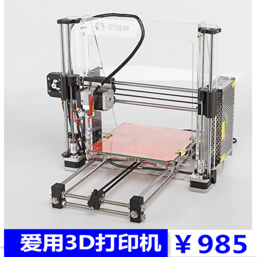

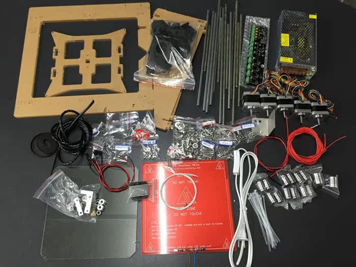

I’m sniffing around thinking about an i3 too. At the moment I’m thinking while in China I’ll buy this to get me started and upgrade from there. It isn’t RAMPS based so I might ditch the electronics, not sure. Is about $CA200 for the set.
http://item.taobao.com/item.htm?spm=a230r.1.14.1.jXfAXz&id=41883358572&ns=1&abbucket=2#detail
looks like a Melzi controller, same as the Mendel90
At $200 for the whole printer, I would be very surprised if that’s a real Melzi. Inspect the solder joints on the board and that all electronics are rated properly. If the printer comes with an acrylic frame as show in the first picture, I recommend replacing that right away with laser cut wood or aluminium from @Big_Mak.
I would inspect the solder joints carefully on any board that comes from
China. Don’t ask how I came to this, but it wasn’t pretty.
