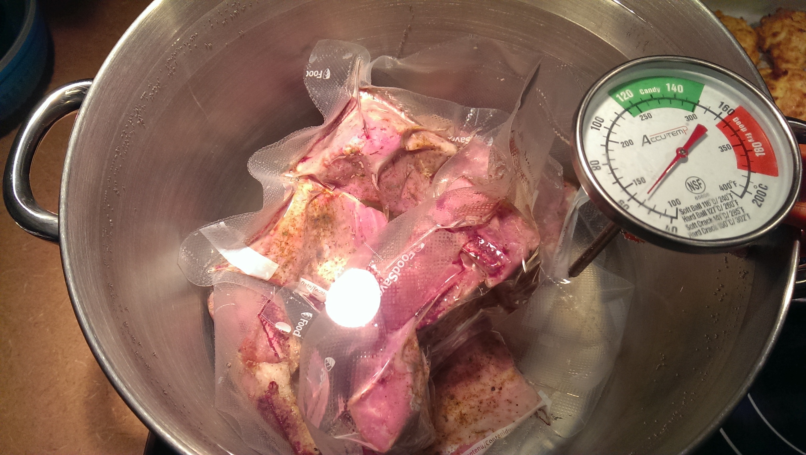

I’ve had amazing results(48hr Short Ribs) simply by using a large stock pot, and a thermometer on the stove, and monitoring the temperature.
My 9 year old son has stated that the short ribs I made were the best meal he has ever eaten. He is ultra picky.

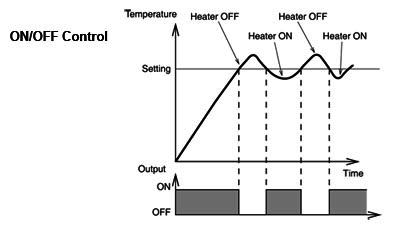

The problem with using these temperature controllers is they are dumb. Basicly when they detect that the temperature has gone over a certain level they turn off, when it gets too cold they turn on the heat. You get this temperature profile that looks like a sine wave.
This is NOT A PROBLEM for Sous-vide cooker as the meat won’t care about a 0.1C wave.
If you want to over engineer this simple project, you need a PID loop that creates a temperature profile that can react to the characteristics of your cooker, the amount of water, and the density of what you are cooking. To do this you need to reduce the difference of the wave of temperature differences. There is a ton of research on this topic.
Its pretty easy to copy from the research into PID loop and build a system with an arduino or similar microprocessor and a relay. It would cost about the same as the above digital thermostat temperature controller.
I thought thought it would be worth mentioning.

Sweet deal . Here is my rig for short ribs. 48 hours later they were yummy.
