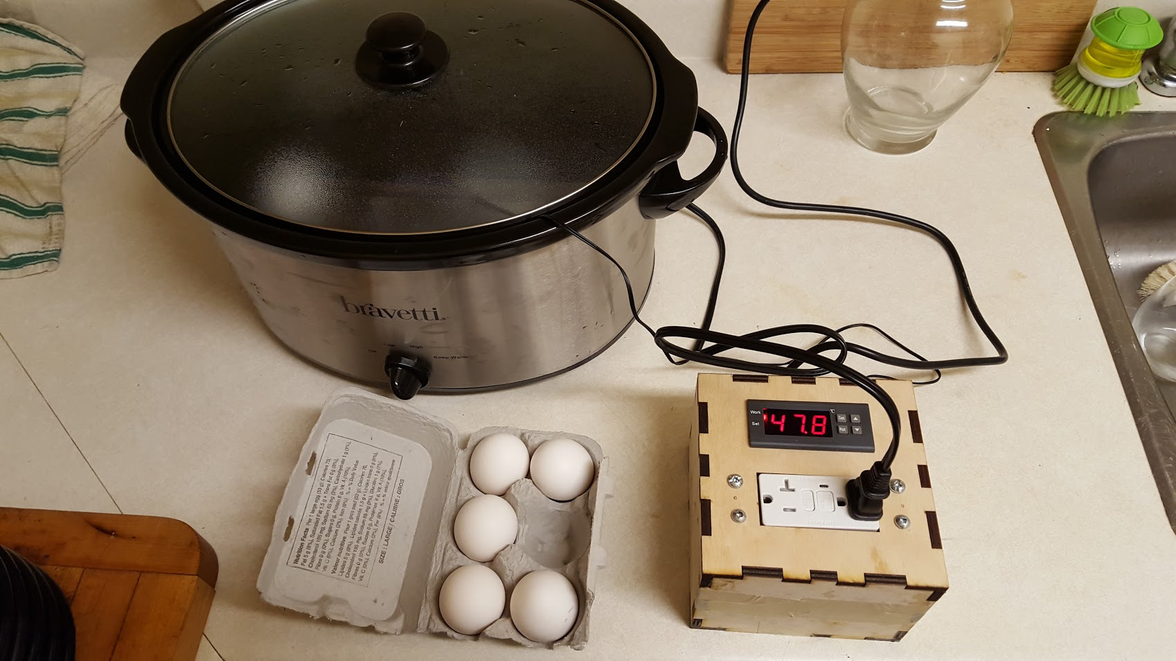

I got the same controller.
Here is my version. #notabomb
https://instagram.com/p/79p2IRg5SG/?taken-by=funvill
I also used a GFCI outlet because I am paranoid
The box laser cut files are in my github
I plan to test it this weekend with MEAT, so far it works well with eggs.

I did another round of eggs last night but the temperature probe was sitting on the bottom of the crock pot and got a invalid reading (hotter then it actually was). I am going to have to make a little stand for the temperature probe to sit in the middle of the crock pot.

Built one based on @funvill’s design, even stole his .dxf’s for the housing and so far it’s working well.
First I found that the temperature wasn’t very even, as I move the probe around it would change by 3 degrees so I added a small water pump to the mix. Dropped this guy in the water now the temperature is the same no matter where the probe is placed.
However it does feel pretty sketchy dropping a 120v submersible water pump in 65 degree water. I think the element of danger makes the food taste better.
So far I’m at $12 for the controller, $5 for the pump, $4 for the crock pot (value village!), $2 for the outlet. Not bad little project for under $25 bucks - thanks @funvill!

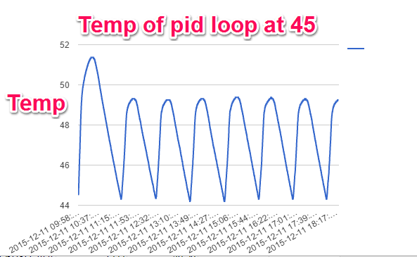

I keep forgetting to post the charts and graphs.
Here is one for my meal tonight
Raw data.
As you can see. there is a pretty wide swing in the PID loop. I must have forgot to set it up correctly before I plugged it in.
