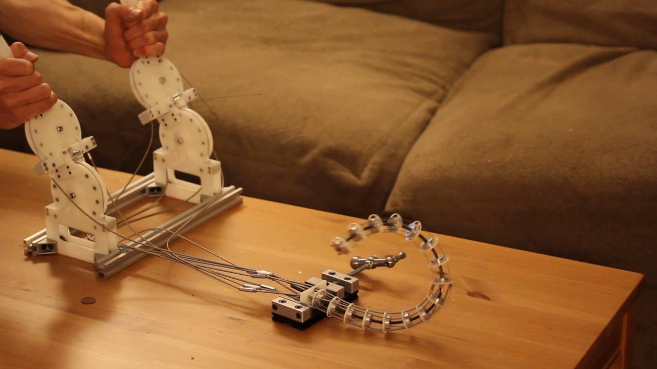

This is what I’m thinking of:
I want two independent sections with the ability to handle the weight of the OLED screen at the end…
And I want it servo controlled…
Is that the scale you are thinking of too?
The designer of that particular one has posted the drawings, bill of materials, and even construction plans online. (And done a pretty awesome job - wow.) Would need to choose an alternative material to Delrin to do the laser cutting at VHS, and replace the hand controls with some beefy servos. Probably need to modify the vertebra as well in order to accommodate cables for the eye.
I came across this design too, that does some basic tracking using ultrasonic sensors: https://www.youtube.com/watch?v=Lz3rPD9anrk

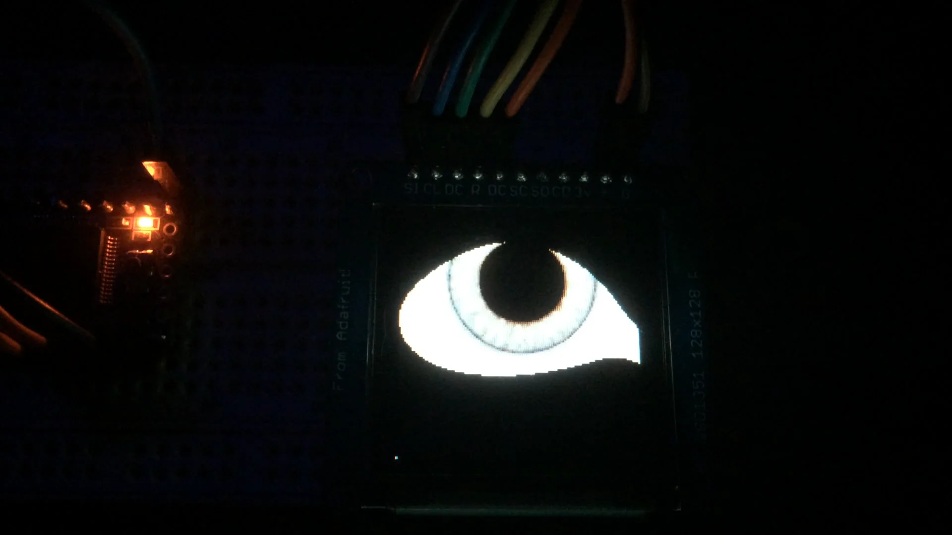

I had a Teensy 3.1 sitting around and ordered the OLED display from Digikey…
Here is a dark and badly shot video of it:
It looks much better and doesn’t strobe in person…
The OLED display is pretty pricey ($56) but the code also works with the TFT display ($20) but I couldn’t find any in stock (and Digikey had the OLED version that got delivered in 1 day)…

My plan will be to mount the display and the Teensy on a 2.5" round PCB and house it in some saucer shaped thing… This will be on the end of the tentacle…
Now to find the acrylic lense and some sort of housing…
And if I don’t get anywhere with the tentacle mechanism the eye will make a decent “mad eyed moody” prop…
