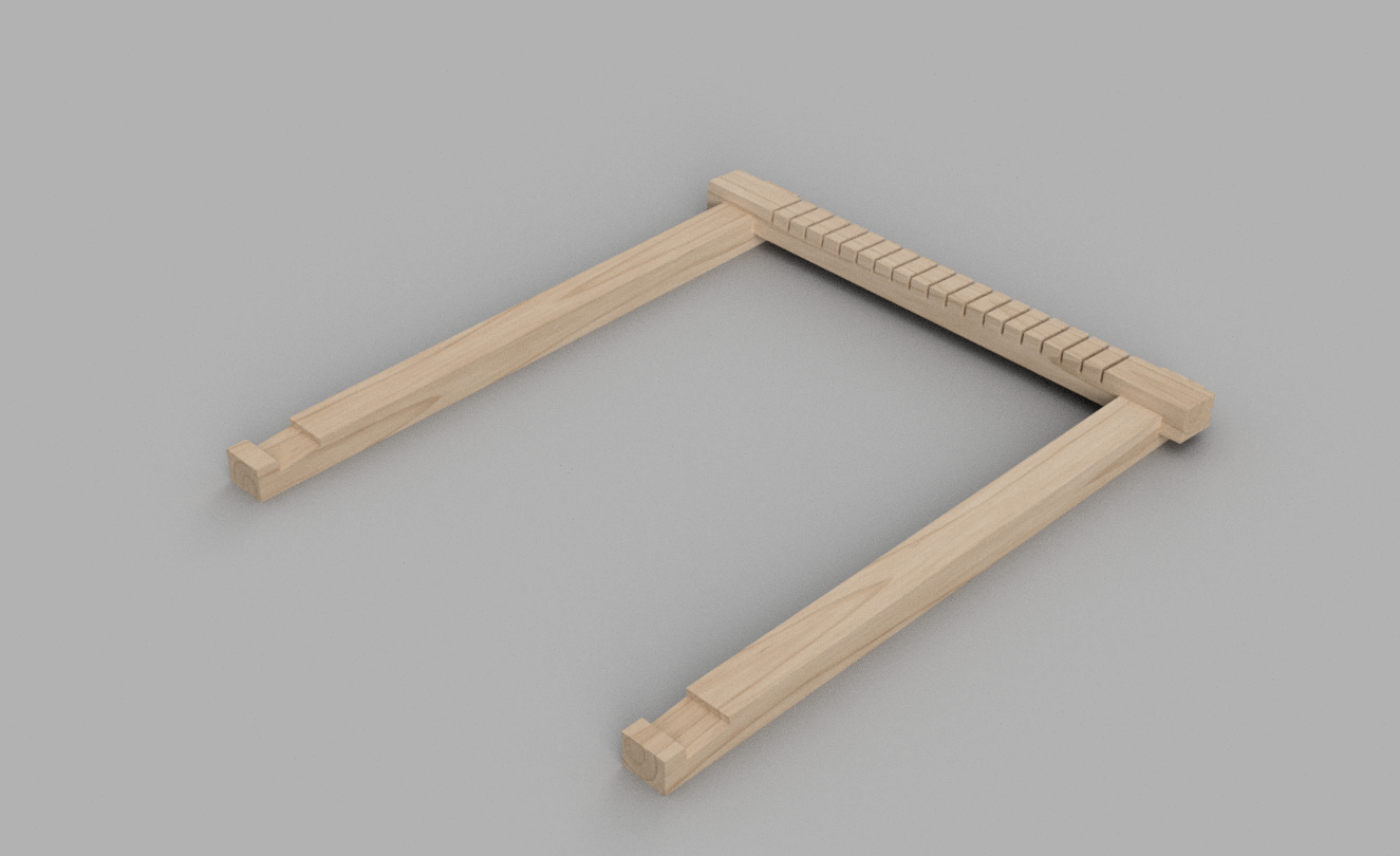

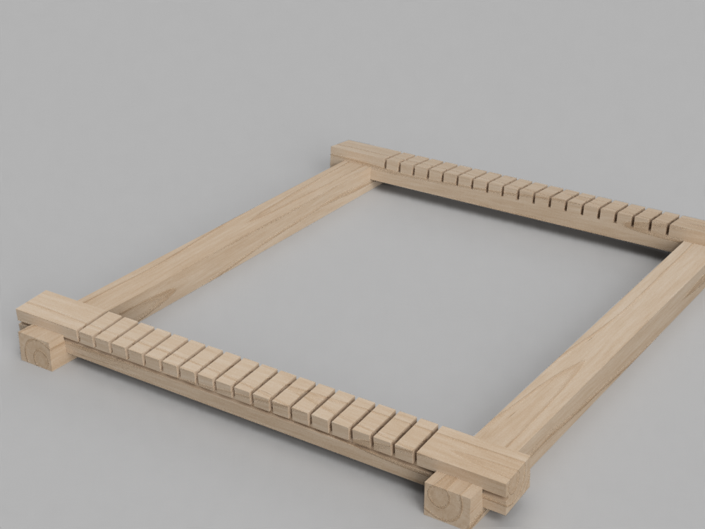

So I designed one myself (Fusion360 drawing here):
I used some cedar that I had extra from another project; turns out cedar is much too weak for those little knotches. I was going to make this out of some maple, but that would have cost me about $10-15 in wood; and we fully expect that I’ll need to build a larger one after she learns the basics of weaving.
Included in the Fusion360 drawing is a lasercut pattern I used to overlay on top of the knotches.

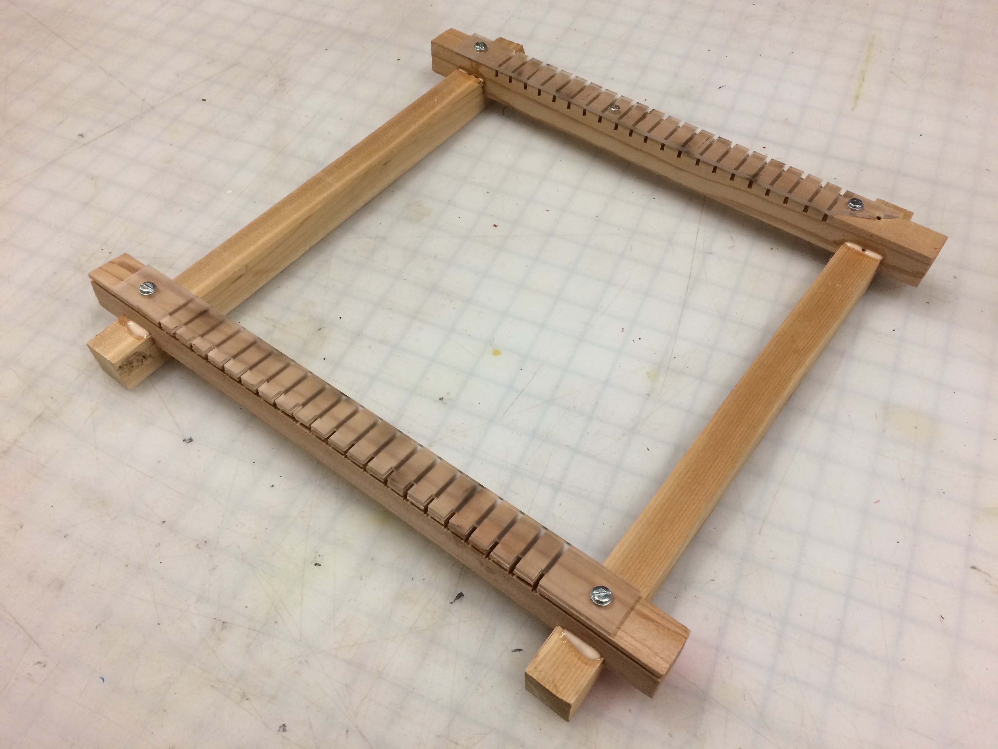

The final product can be seen here:
I could have lasercut the screw holes, and that would have saved me a lot of trouble, I ended up drilling too quickly through them and cracked them. You can see my ‘fixes’ for that, but this should work for the first steps of learning.
