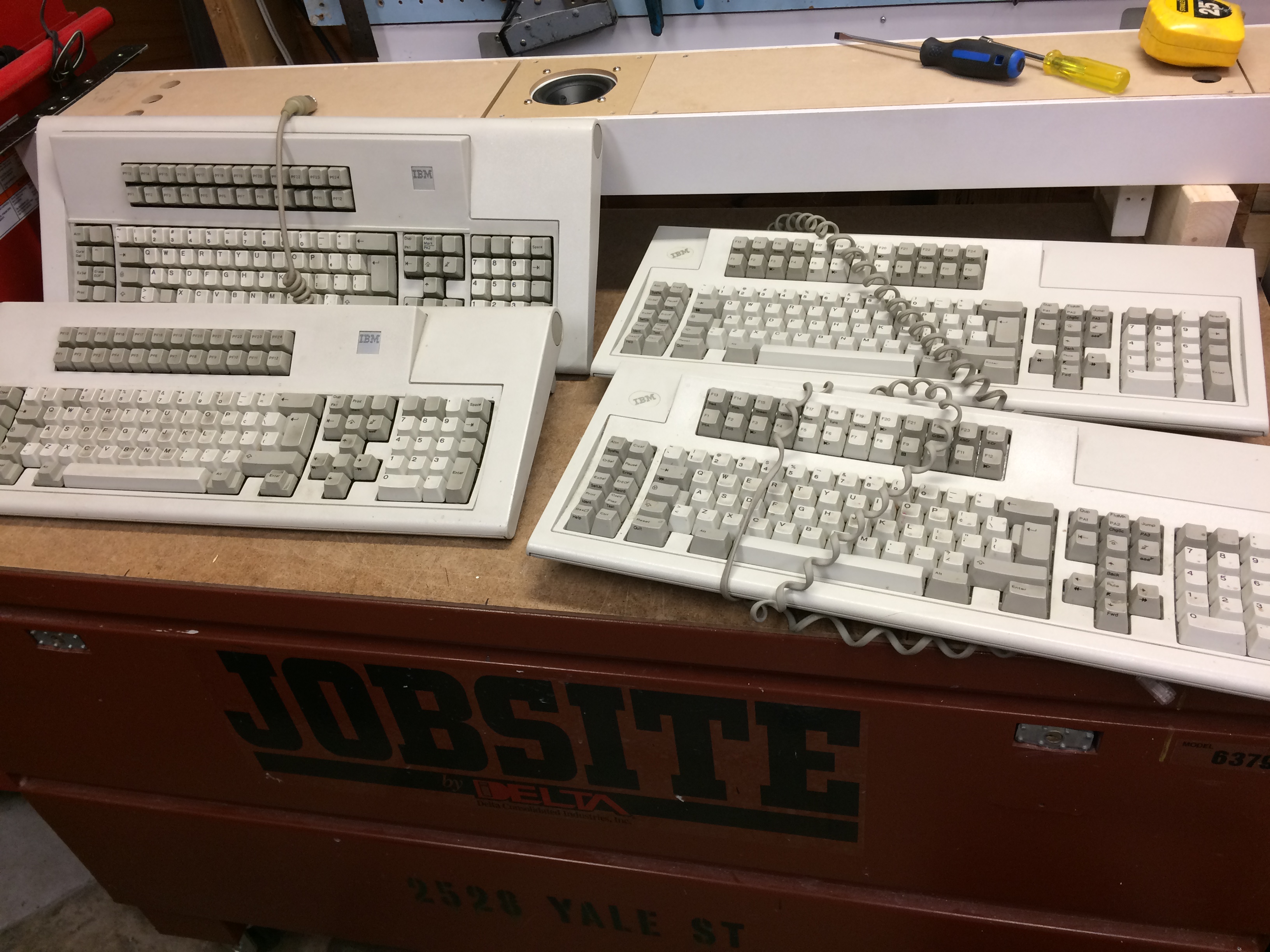

So I came across some old IBM type M and F keyboards…
The type M on the left are really friggin heavy

Also have a few no name clone type F’ish keyboards that will leave in the 3 week bins once I know I don’t need any of the key caps…

Ah…this takes me back. Are you gonna put the one you want through the dishwasher?

I remember those old keyboards. They were so comfortable to type on. Ah, the good old days…
