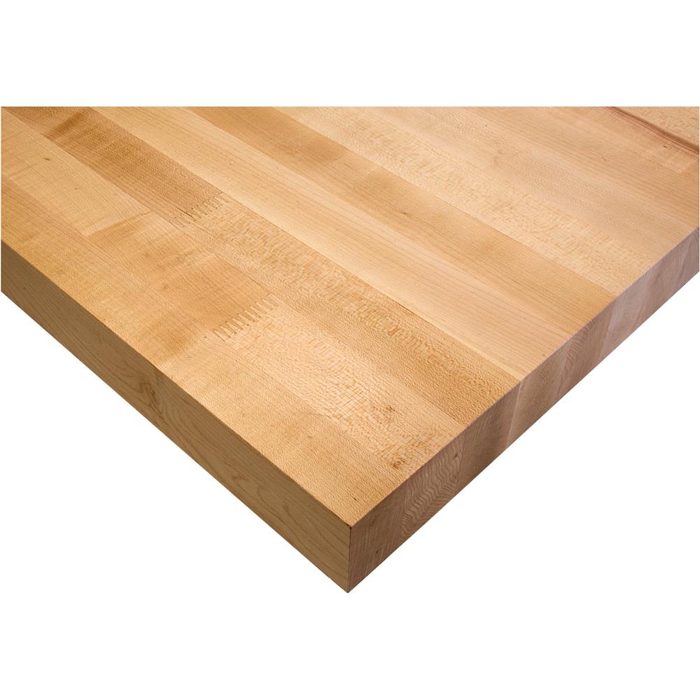

I have maple butch block desks in my office from Grizzly (from when they were on sale and the dollar was more favorable).
http://cdn0.grizzly.com/pics/jpeg500/t/t21248-f53933844522633f7e2d472a40751283.jpg

Writing or drawing on metal sucks. Wood is much better, and or a drawing pad on top works.
Wood tops are cheaper and more easily replaced, they also cushion impact if that matters.
On the other side metal is far more durable, but much heavier/harder to move unless disassembled.
As-is section of Ikea (or even regular ikea) sometimes has these laminated boards in table size and can be good deals.
Laminated 2x4’s are also a reasonably cheap and work great
I’m in the market for a workbench too. We could do a group build of laminated 2x4 bench tops, but it’d really help to have a planer and at least four long bar clamps per person first. :slight_smile:
The laminated hardwood countertops from Ikea are a bargain for workbench tops even if you can’t find one in their “as is” department. In particular, their beech wood Karlby countertop is ideal for a woodworking bench as beech is very hard. For $120 you get a laminated beech wood slab 74" long by 25" wide by 1.5" thick. This is far cheaper than benchtops from Lee Valley and other woodworking stores and way more convenient that planing and gluing up your own slab.
Keep in mind that laminated 2x4 are very soft and, when you buy them, their moistue content is in the range of 25 to 30%. That’s pretty wet. It also means that, if you don’t stack & sticker them and let them dry for several month before building your benchtop, it going to warp and deform quite a bit as the wood dries out. Also, the quality of 2x4 you can get at the home centes these days is pretty abysmal. 2x6’s and 2x8’s are generally of better quality than 2x4’s.
If you’re bound and determined to build you own benchtop then you’re better off going down to PJ White Hardwoods and buying some maple boards than using dimensional construction lumber.
