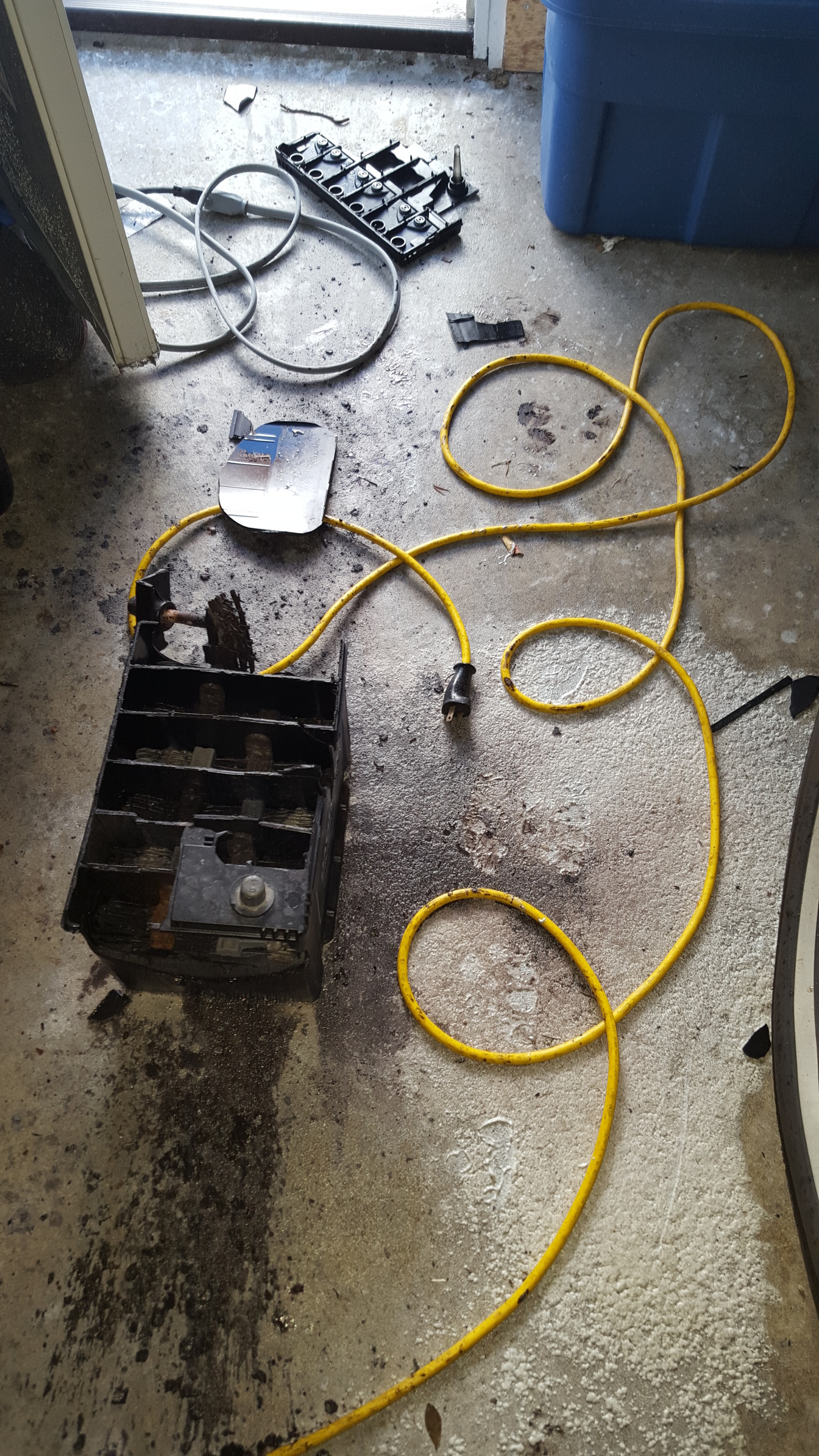

What do you think would cause a car battery to explode? My SO’s car battery was dead and was reading 6.5V before I put it on the battery charger a few days ago. When I left it, my small 6A charger was reading 3A. I came out to the garage today to put the battery back in her car and this is what I found. Now I need to find where to dispose of an exploded battery…
Overcharging with high charging voltages generates oxygen and hydrogen gas
by electrolysis of water.
The buildup of pressure would cause the lid to pop pretty violently

Not an expert on car batteries by any means, but I do know that the chemical reaction caused by charging generates H gas. If this gas could not vent effectively because the vents were blocked, or if it got ignited by a spark or short circuit somewhere, I can imagine this would be the result.
wow! looks like something from MythBusters
I done that before, but with six recycled car batteries in a sealed shead. Charging
batteries released hydrogen and if the batteries are not in a well
ventilated area can explode.

Judging by the lack of scorch marks, there does not appear to have been any pyrotechnics. The black debris you see in the photo is mostly shrapnel from the battery casing. If it exploded from hydrogen buildup then thankfully it didn’t ignite. The battery was sitting about 2 feet away from my beloved '67 Mustang and there was (thankfully) no damage to the car.
My battery charger, like most, is supposed to go into a trickle charge mode once the battery is fully charged so I would be surprised if overcharging was the cause of the explosion. However, I’ve had that battery charger since about 1978 so it’s possible that it is no longer functioning correctly. If the future, I won’t be charging batteries in the garage!

Glad you weren’t around for the big pop Steve. I’ve seen batteries crack, but I’ve never seen one go like that before!
I have a spare charger if you want it. It has to be newer then 1978. By how much no idea.
Its possible that your charger was working properly. Just takes a very small spark to light hydrogen. static electricity perhaps? There’s the good example why despite how much better hydrogen gas is over gasoline we still don’t use it.
“…My battery charger, like most, is supposed to go into a trickle charge mode once the battery is fully charged …”
The battery was not rechargeable anymore, too old, too discharged. The charger is most likely fine, it just never saw the changes telling it to switch mode.
There are modern chargers out there that will detect a badly sulfated battery and attempt to fix it before going into charge mode. Sometimes it works, sometimes the “intelligent” chargers tells you to get a new battery. These chargers are well worth the $85 or so .
Never bother to attempt to recharge a nominal 12V battery if the voltage dropped below 10V. It D-E-A-D, chemically non-reversible, I guess…

Late to the party, but when charging motorcycle batteries 10+ years ago, I always made sure to unscrew the caps on top, so the gas could vent. Is that no longer a concern? :slight_smile:
