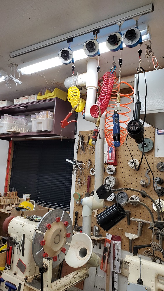

I made a huge mistake on my current woodturning project so I decided to take a break from the project while I contemplated a fix. In the meantime, I decided to make a little improvement to my turning station.
For years I’ve had a couple of pneumatic tools attached to retractable spring balancers hanging from the ceiling over my lathe. They were attached to screw eyes screwed into the ceiling. While doing some cleanup I came across a sliding bracket that was designed to hang the balancers from. Since I wanted to hand a couple of more tools over the lathe and I had a couple more balancers, I installed the bracket to the ceiling over the lathe with the two extra balancers.
Here’s a closer look at the balancers.
Since I only had two compressed air connections installed on the wall above, I added a manifold to one of the regulators with 3 female quick-connectors.
Since I’ve been doing a lot of airbrushing at the lathe lately, I cobbled together a quick and dirty portable air filter/regulator for my airbrush that sits nicely on the lathe bed and connects to one of the air lines hanging from above. It has it’s own air shutoff just before the filter.
