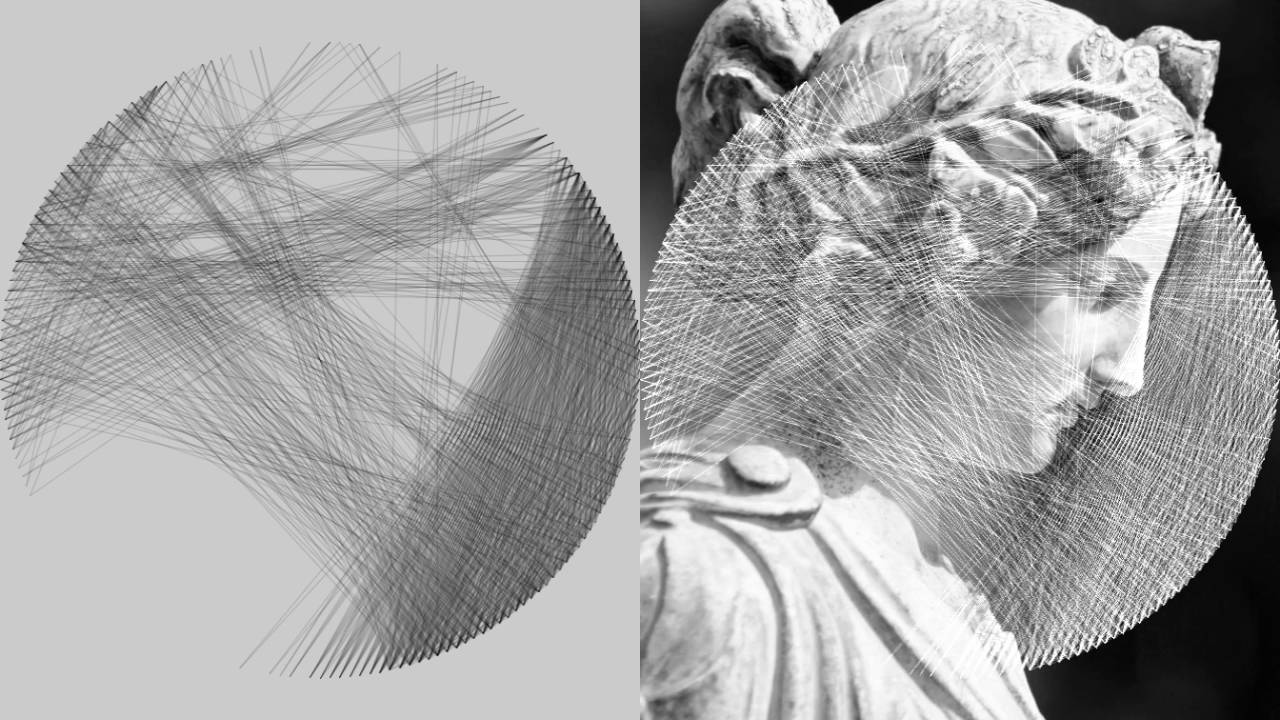

Here is another attempt in Processing with a subtractive method - every time I draw a line on the left I subtract it from the right.
http://i.imgur.com/l1VBzFP.jpg
Same again, but the end of one line is not the start of the next.
http://i.imgur.com/CjtddYN.jpg

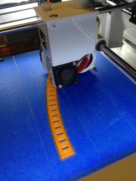

As a funny aside. I don’t recommend measuring 11/32" of an inch around a 22" bicycle wheel by hand and hope that you get exactly 200 points! Did not work for me. I was only off by 1 so not too bad. :slight_smile: So Fusion 360 and 3D printing to the rescue. A marking guide with a 22" diameter arc with a slot every 1.8 degrees to the rescue. Works like a charm.

I tried both line-follows-line (A-B,B-C) and independents (A-B,C-D). The last image I posted is indepent lines. LFL is much faster to calculate and is arguably worse (second last).
