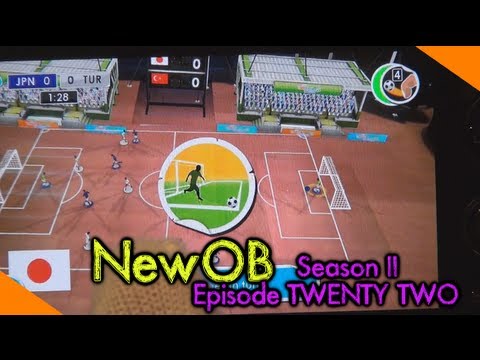

PS Vita uses a system of unique cards with printed patterns (like simple QR codes) and ties specific elements of a game to a card. For example, there’s a soccer game. One card represents the home goal and another represents the away goal. You can change the size of the pitch by moving the cards further apart. FYI, there’s also cards for the stands, scoreboard, and a few other things.
