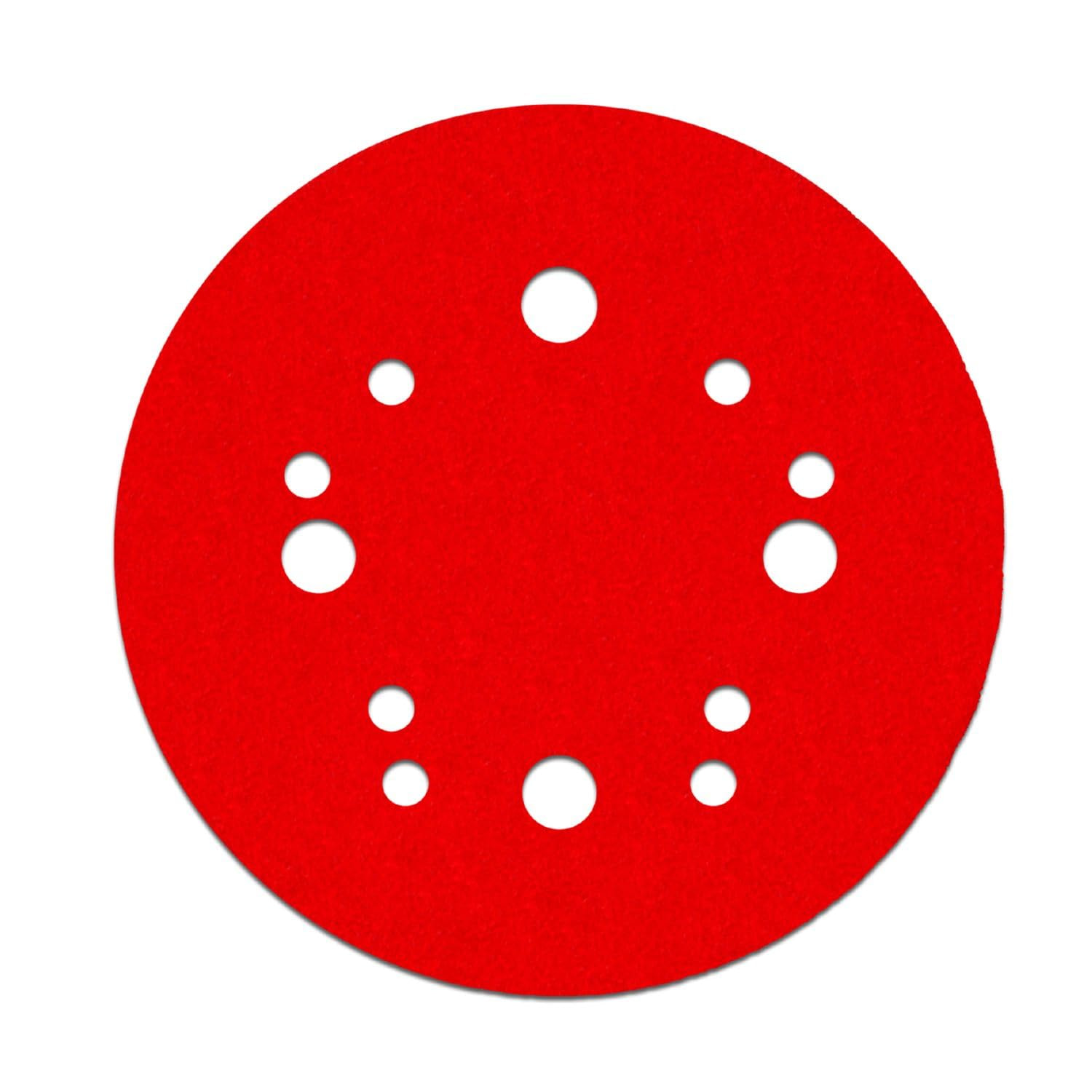

Generally speaking for 5 inch orbital sanders i’ve historically gotten diablo sand paper from home despot. Mostly because it’s easy to pick up at a whim and does the trick.

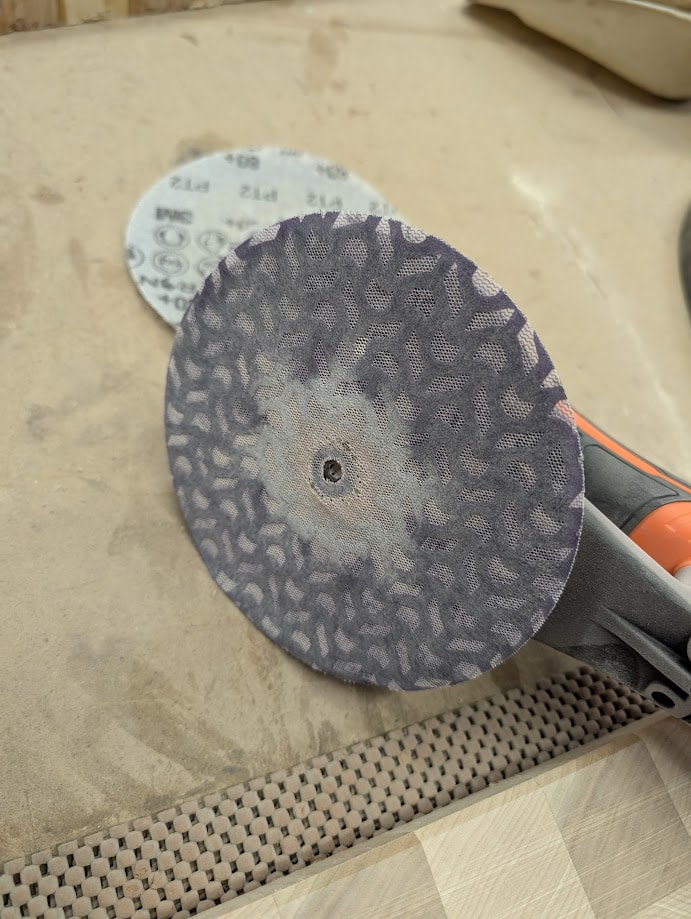

What is greatly preferred however is the 3m cubitron sand paper.
- Diablo Sand paper
- 3m cubitron sand paper.
There is a wide gap between the quality of the two sand papers here. The diablo (red one) have very few holes for dust to be sucked out by your dust collection. So it is far dustier to use than the cubitron stuff. The cubitron sand paper is also mesh so it has much better airflow through the paper into the dust port. The grain on the cubitron stuff is also far superior in that as it breaks off from the sand paper you’re still left with jagged pieces that continue to sand. The result is something that is better at dust collection while lasting longer. They do make 5 inch cubitron sand paper but finding it in stores can be a hit or a miss and if you’re buying sand paper you really should splurge and get the better stuff.
