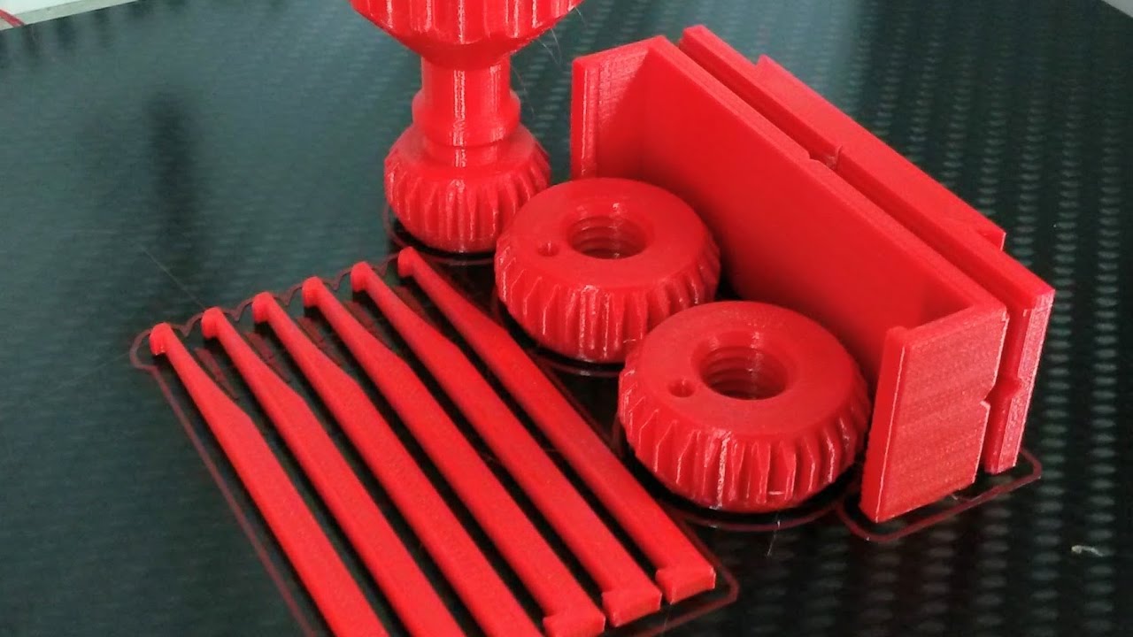

Tip for removing 3d prints from a clean build plate
