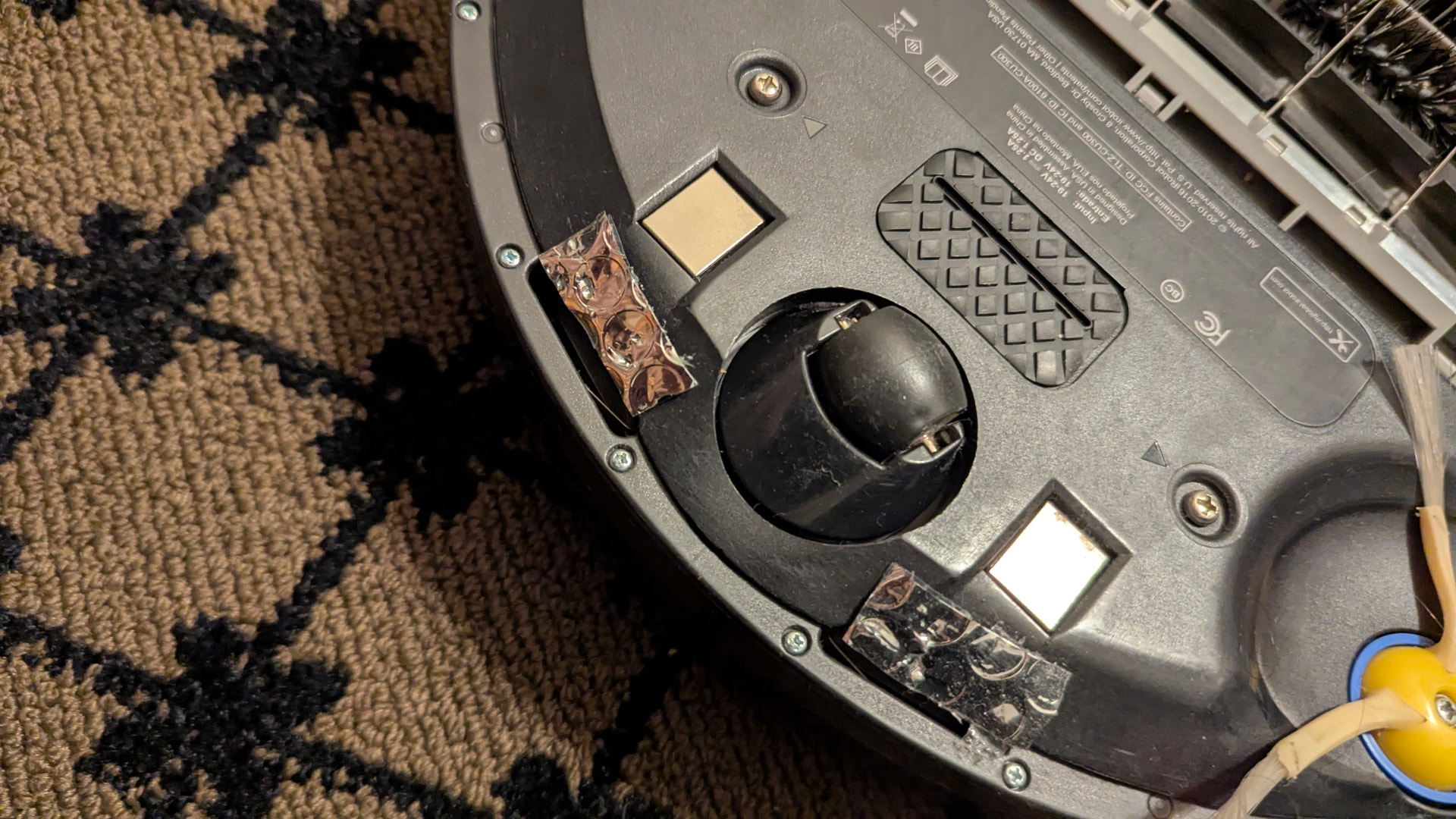

The Fix:
The fix was to trick the Roomba with shiny reflective foil tape. Shiny tape over the cliff sensors easily reflect back the IR and keeps the Roomba happy and sailing along no matter what colour carpet it is cleaning. Now if only we could all stick shiny tape over our eyes life would be good. :wink:
I had zero foil tape on hand but I did have the adhesive flap cut off an old insulated double-sided foil bubble wrap envelope. I cut it up, stuck the adhesive side on the sensors, and my Roomba is happy again. This will work as a temporary fix.
This fix took 5 minutes and now I don’t have to vacuum my place by hand. Hooray!
