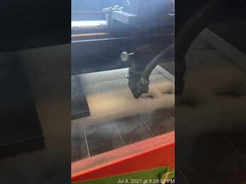

Super successful cut with 3/4" EPE Foam from foambymail.com!!
I’ll post the video. No noticeable smell. Hardly any smoke. Super nice cut!
Had to guess a little bit to focus the laser at 19cm but it worked OK.
