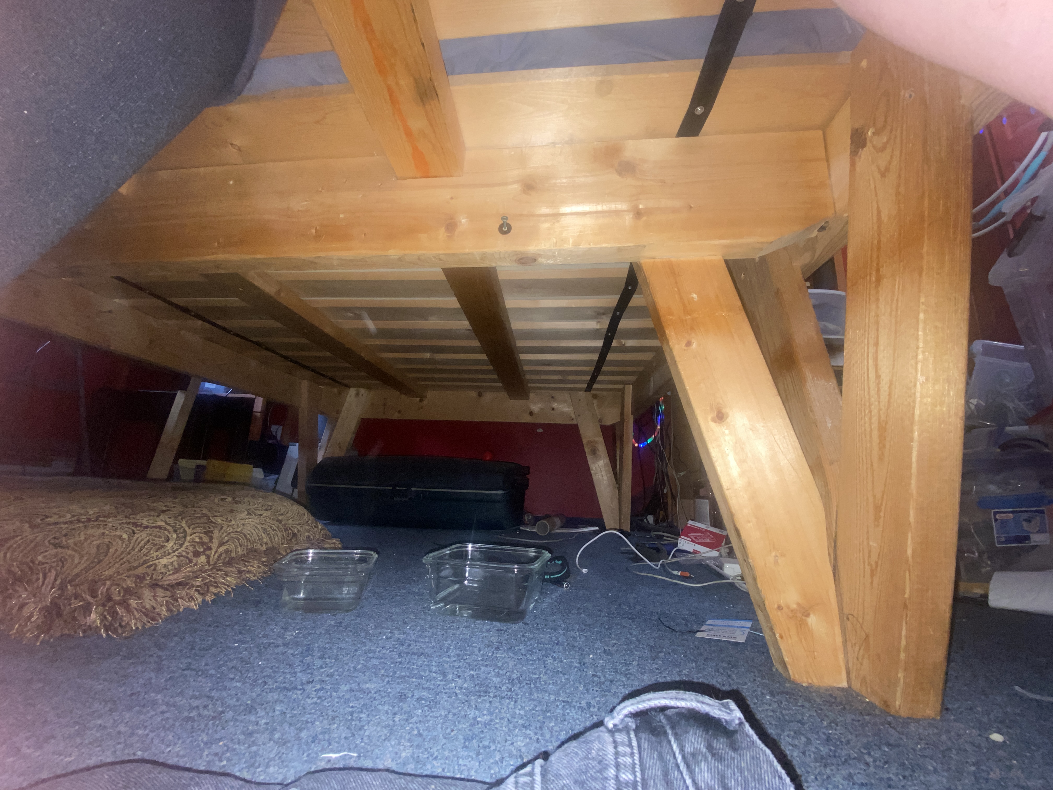

I have to remember to take a picture of my bed when I get home. A friend of mine, made it for me (as a paid gig) many years ago. He was broke in the moment and I had always admired his bed design. So it was win win. His bed design… maybe 25 years ago he fell and broke his back and as he spent a lot of time laying in bed healing he imagined it up. (He’s an accomplished woodworker). It’s a neat design, maybe it will inspire. It’s also designed to be fairly…. you can break it apart and move it without too much trouble. The height can be chosen on build. Anyways, lots of words, pictures would be awesome, but I’m not there now, and I figure I’ll post so I remember to add pictures later!

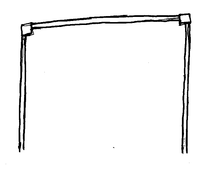

Here’s the biggest revision I am considering to the original plans. The Ana White design has the long frame sides butted up against the shorter ones, thusly:
I propose doing something like this:

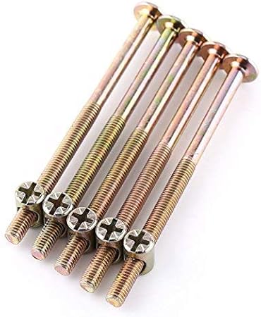

The short frame ends would be attached to the legs permanently with pocket screws and glue. The long ends would be attached using what are called furniture bolts or connector bolts and barrel nuts, dowel nuts, or cross dowels (there is a variety of names for both). These things:
Why? First, going by the engineering decisions in Ana’s plans, the short member would be attached using 2½" screws in 1½" pocket holes (I would probably also use glue on the face of the short member resting against the leg). The screws would protrude about 1" into the 4✕4 legs, which are actually 3½✕3½. This yields the other 2½" to be free to be drilled to accept the bolts running the other direction (I could, and probably should, use 3" screws, which would still leave 2" free). So it seems at first glance to be workable; at least, it is not impossible per the rules of Euclidian geometry.
By using bolts and nuts to secure the long-side members, I would make it easy to disassemble the frame into smaller pieces when moving time comes. Unlike with disassembling wood screws, I could disassemble and reassemble the thing multiple times without adversely impacting strength.

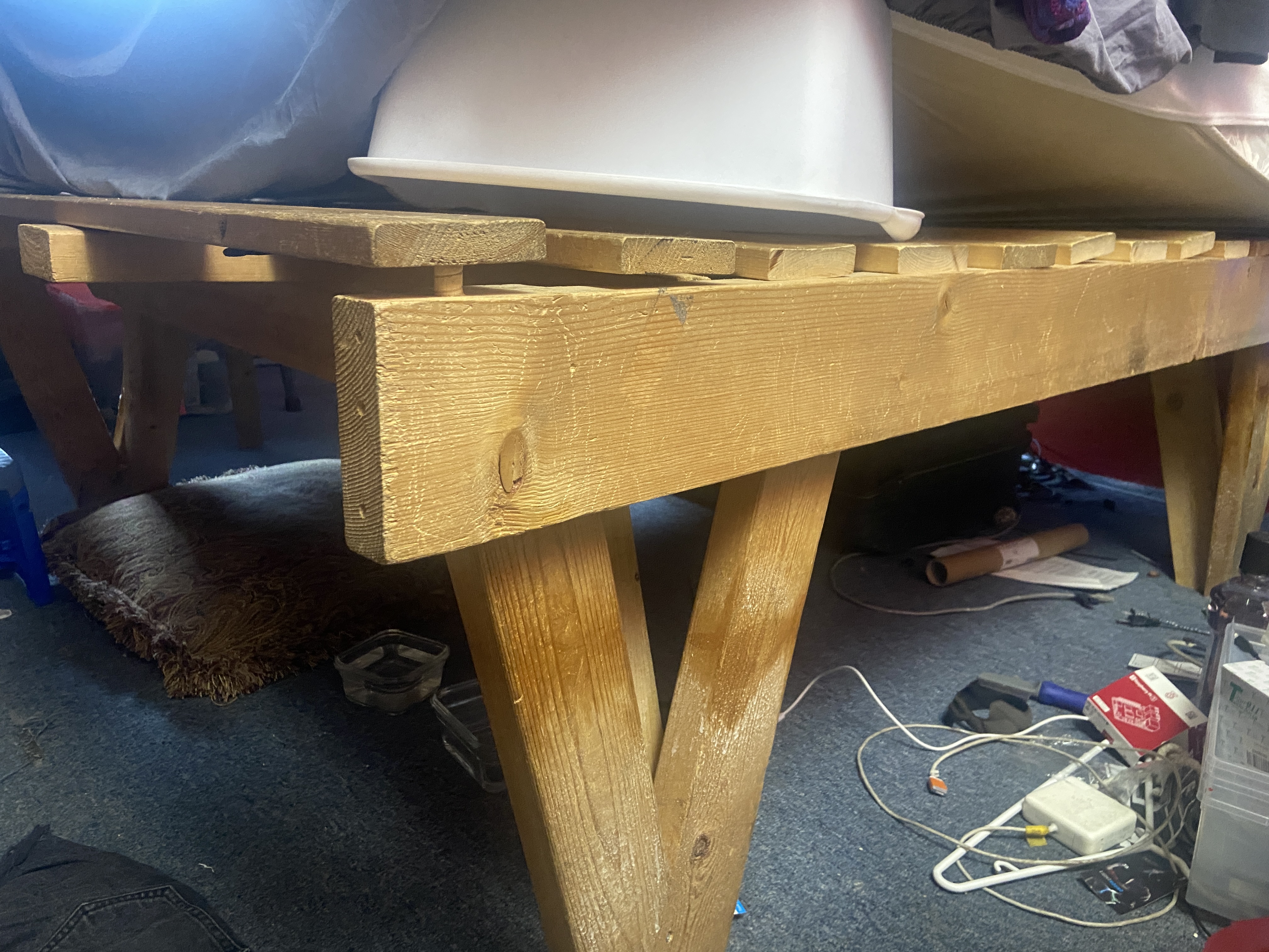

This might be too late and you should def do what works for you, but the bed i have a great, strong design. I could get more pictures if you had compelling interest, it would just require much more effort, so this is a taste that should give you an idea of interest.
Let’s see if the pictures made it. Yes, my floor is a bit messy. The second picture is just to give a different angle and the small plastic tub is just to raise the mattress a bit.
