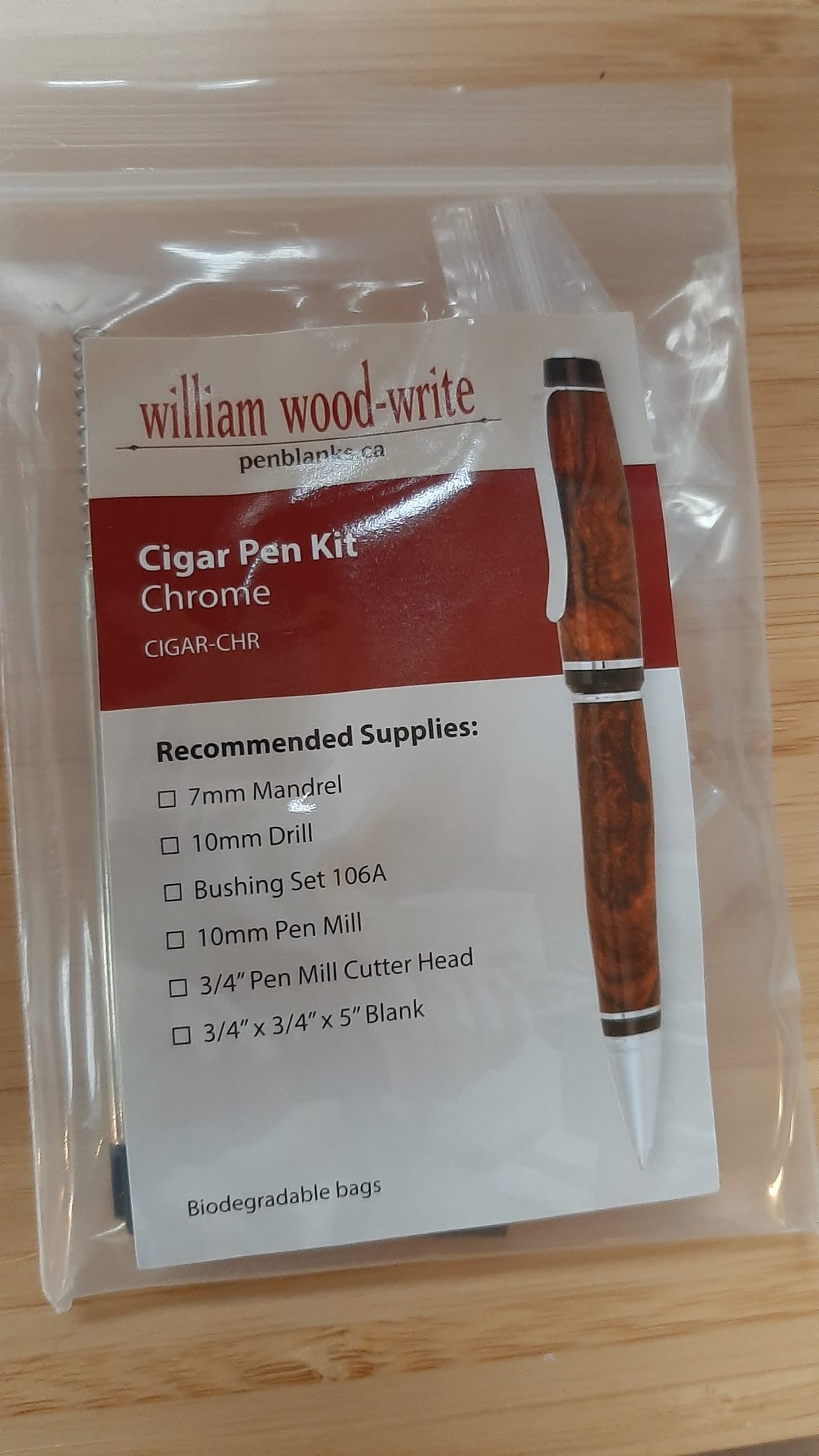

I ended up with this guy as an effort to buy from Canadian companies - handy little list on the front of the set!
Nice choice - that’s the pen kit i usually make. I should have all the supplies for that set i think.

Looks like the bushings are:
  1. 11.9mm
  2. 14.6mm
  3. 12.5mm
  4. 11.5mm
So yeah, that’s the only measurements I can find and those are some tolerances that I will likely struggle to recreate lol!

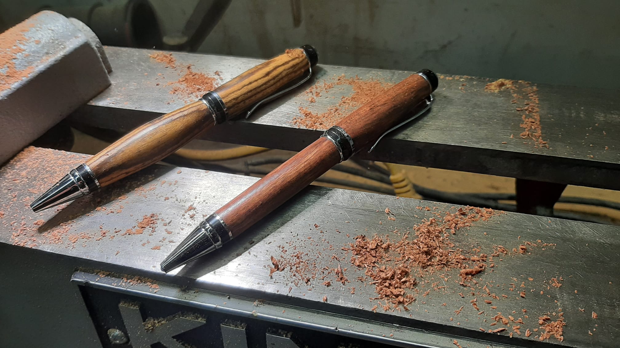

Thanks @Phillip_Ma and @WDaynes for the insight, guidance and extra gear for this project! I’ve made 2 pens I’m really proud of and they’ll make some excellent xmas gifts!
