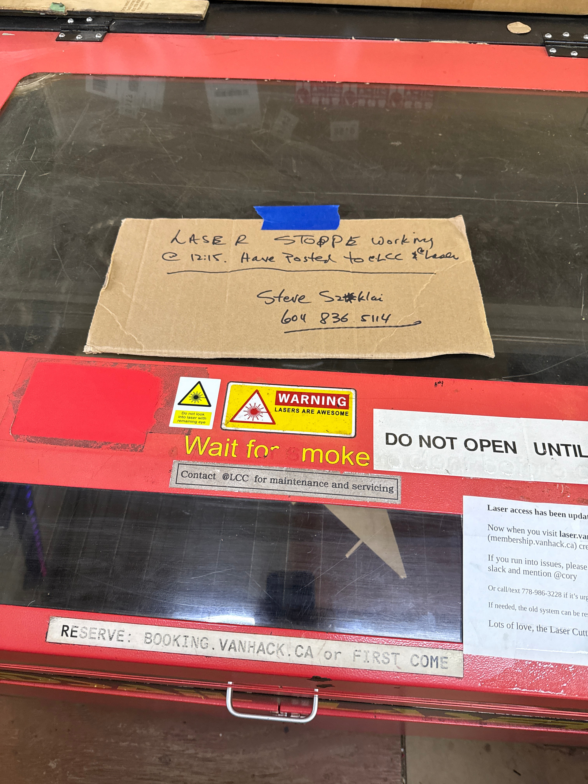

Laser is back up and operational.
In short, the laser won’t fire if the chiller isn’t on - this is to prevent running it without the chiller and burning out the expensive laser tube. The chiller wasn’t on because a plug was part-way un-plugged.
Thanks to @KeyNoteSteve for doing most of the troubleshooting on this one! :slight_smile:
