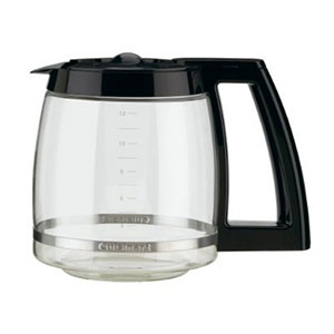

My coffee pot is leaking. Safe fixes?
http://www.geekinspired.com/wp-content/uploads/2009/01/cuisinart-12-cup-carafe.jpg
I have a cuisinart coffee pot. the handle, top rim, and lip are all from one molded piece of plastic. It was fine for about 3 months but now it’s turned into a comedy dribble glass. How would you fix the leak if you were going to drink out of it a few times a day? Replacing the pot costs more than replacing the entire coffee maker, which HP-printer-level stupid.
