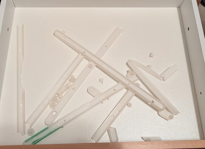

Every single one of the plastic drawer slides broke on this cheap wardrobe I have.
The carnage:
So I used the least broken one as a template to make new wood slides. They work, just don’t look too closely:
Luckily, one of the plastic pieces was still intact enough to use as a template to mark out the mounting holes.
Tada, drawers work again. I rubbed some snowboard wax on them to make them a bit smoother, although I’m not sure that did anything.
