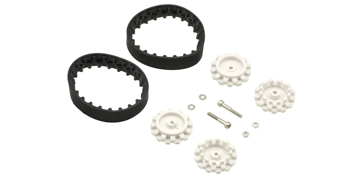

I have this robot which comes with silicone tank treads:
I’m looking for a compound to paint onto the treads to increase their grip on a flat, painted surface (the sumo ring).
