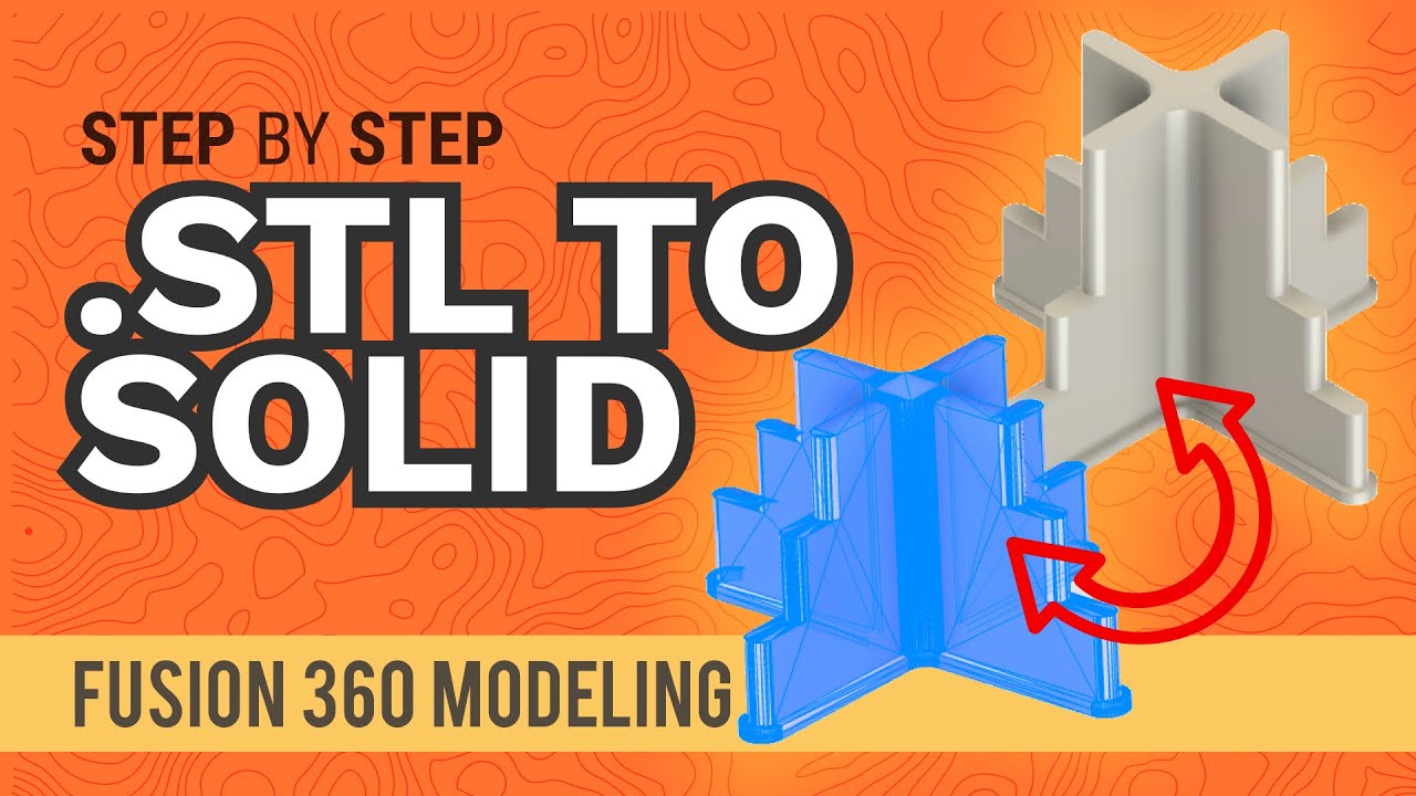

If you’re having a…challenging model for 3D printing, this is an interesting and very short video on how you can “collapse” a Mesh object (STL) to a solid object!

One thing he didn’t cover is importing the mesh in the first place so that it is properly scaled. This is a common task, for example, if you want to modify an stl downloaded for 3d printing from Thingiverse, etc.
The best way to import an stl so that it is properly scaled is to open a new design and use the Insert Mesh Command under the Insert menu. (https://www.youtube.com/watch?v=4pTYW130ApU)
This will provide the option to choose the file and select what units it is in. (Most STLs will be in mm, but the file format doesn’t have units built in so you have to specify it independently)
You can also Upload an stl file under the Data Panel, but this will import it using Fusion 360’s default of cm. That means if the STL is in millimeters, it will be imported 10 times bigger than it should be. (In this case you can use the Scale command under the Modify menu.)
