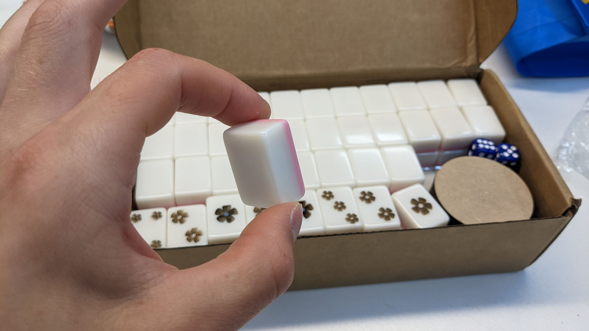

Hi! I have some melamine tiles I would like to etch with a laser. These are melamine resin tiles, not melamine mixed with wood or particleboard or anything. I have had success lasering this at my old hackspace (particularly when using some painter’s tape to prevent staining).
Melamine resin is commonly used for Mahjong tiles and kitchen (particularly camping) foodware. It is similar in feel and function to acrylic.

On my old hackspace’s laser, 100mm/s and 20% power with air assist on and painter’s tape atop the melamine (to prevent flare) worked pretty well. These same settings appear to work well here! My melamine tiles are too tall to focus properly on, however, so I was unfocused by about 8mm, so quite likely less power will also work well. The stinkiness appears low. It takes only one refresh cycle of the air monitor to clear out, even close to the lower left edge.
I’ll update once I’m engraving focused, i.e., at a consistent level of power. Since I am engraving tiles, I went with the approach of cutting a jig in some scrap to engrave the tiles perfectly accurately, but one-at-a-time…

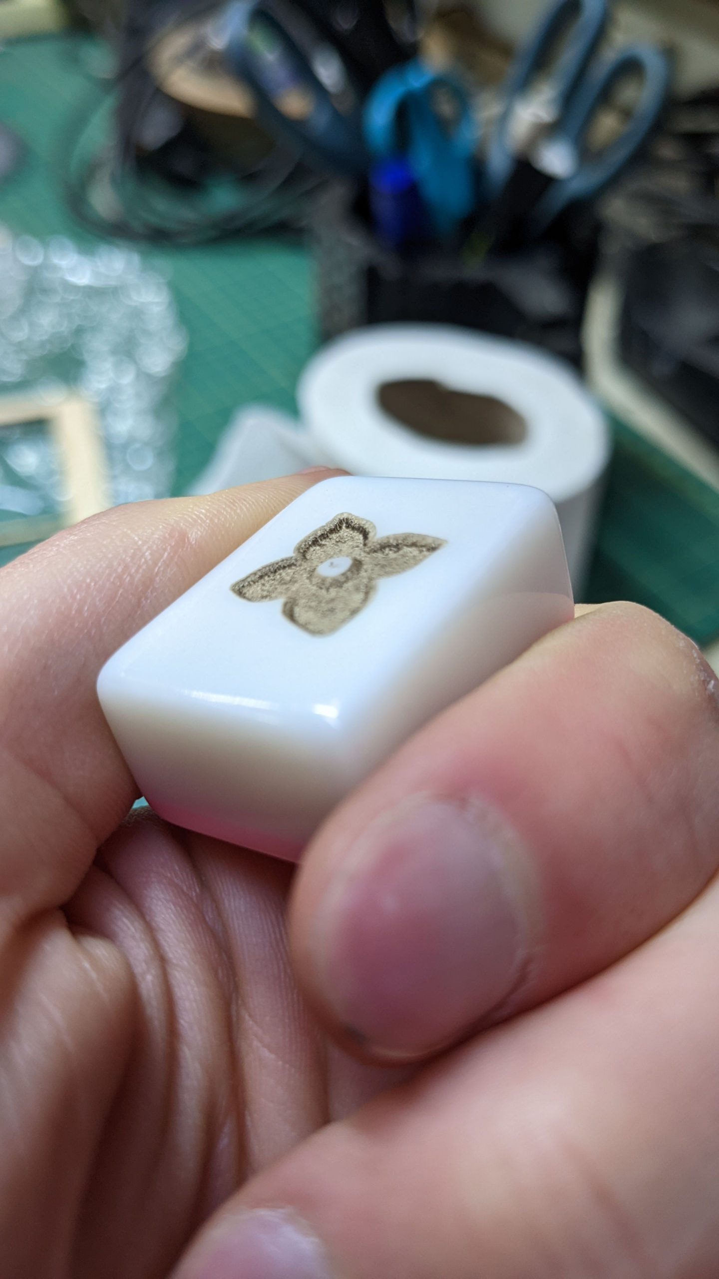

Here’s what two unfocused passes at 100mm/sec and 20% power looks like. The first I did with painters’ tape, the second without. Some flare was produced on the second pass but it didn’t seem to bond to the plastic and was easily wiped off. I think that if the laser was properly focused, the painters’ tape would be more necessary, but maybe not. Useful regardless!
