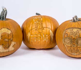

https://www.epiloglaser.com/resources/sample-club/engraving-pumpkins.htm
  • mounted entire cleaned pumpkin in bed
  • recommends using a 4 inch lens for larger focus distance
  • recommends against trying to cut through due to shell thickness and water content; recommends engraving
  • recommends manually focusing between tallest and shortest areas being cut
  • mounted entire pumpkin in bed
  • able to cut through with high power and low speed
  • laser cutting pumpkin creates lots of ‘black goo’ when cut; cleans easily with wet cloth

Practical Considerations for Laser Cutting / Engraving a Pumpkin at VHS
  • The fixed bed means that it will not be possible to etch or cut a full pumpkin - there isn’t enough space between the bed and the cutting head.
  • The current / standard (~2.5 inch) lens is not ideal - it has a very narrow focus depth.
  • The VHS laser doesn’t have a rotational stage, so cutting/engraving will be limited to one plane and will likely be skewed on a curved surface
  • The VHS laser is not food-safe. Anything engraved/cut on the leaser is not for consumption and is for decoration only.

I’ve done this in the past at another hackspace - our focal distance and bed configuration would make this very impractical - we don’t have clearance and depth to get anything but a sliver of pumpkin in the bed.
As normally only dry things are being cut wondering if the moisture from the pumpkin “fumes” affect the filters?
That’s a good point - wonder if the moisture would combine with the carbon dust to form a coating on the filters?
