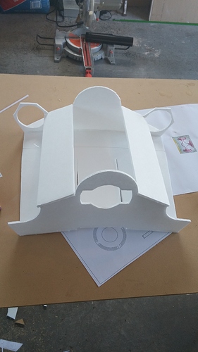

Im looking foward to laser cutting all my pieces for a new and imporved jetpack prop.

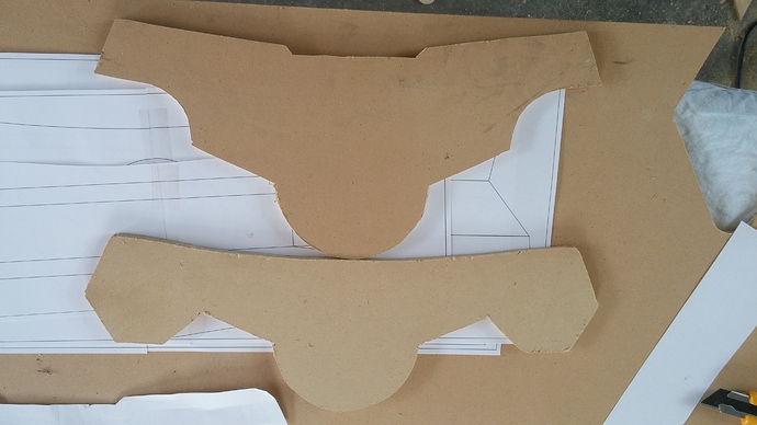

Cutting pieces like trhese with my jigsaw was very time consuming.My end goal is to have a Prop kit for sale that is completly flat for easy shipping. Im just now learning how to convert my pdf files to vecter.

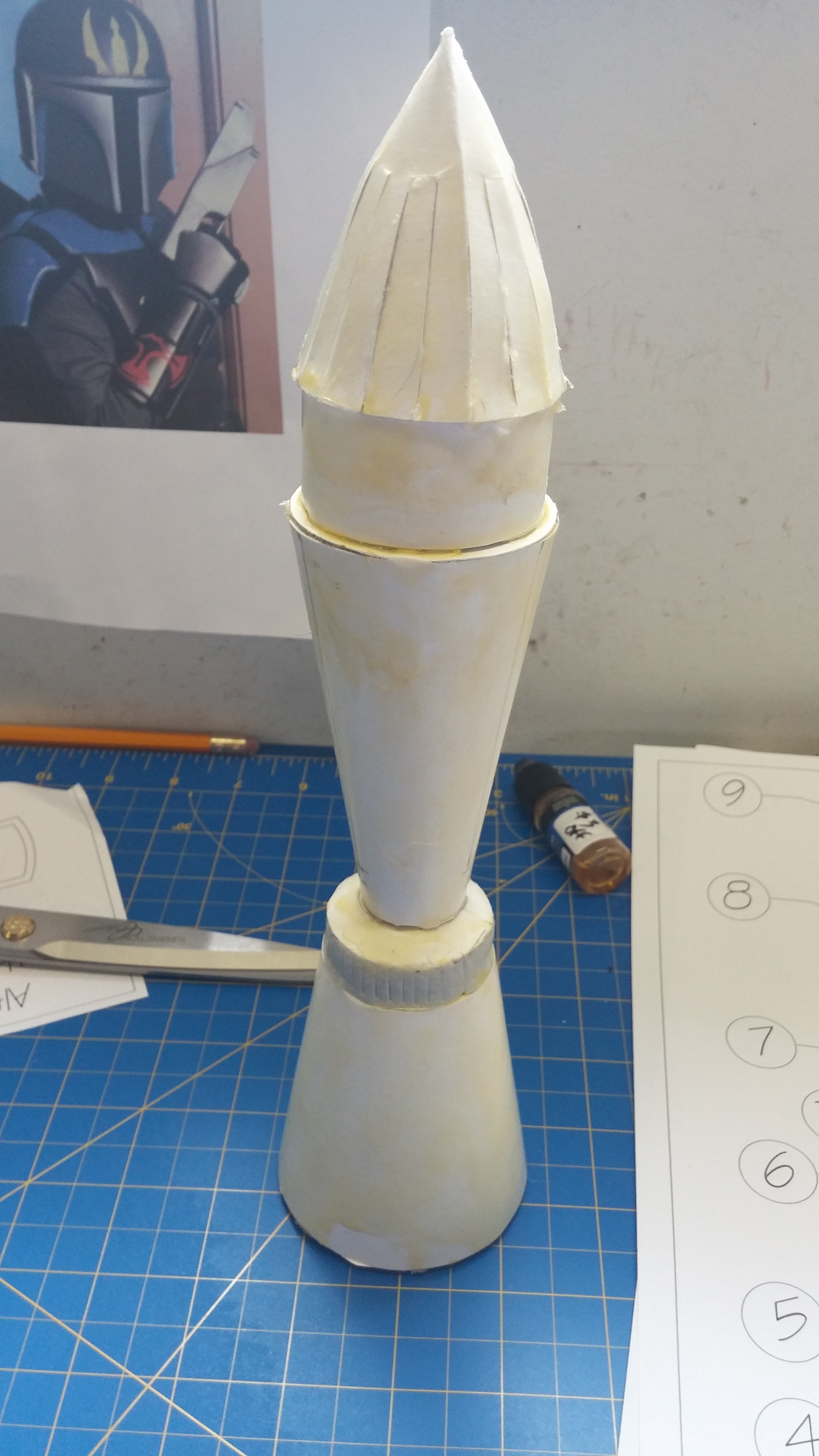

These are all pics of my first design. Where i need some help, is with the curved parts. i know you can cut them, just not sure how yet. For example this is the rocket that goes on top of the pack.I made it from paper templates.
I need a way top laser cut all these pieces.

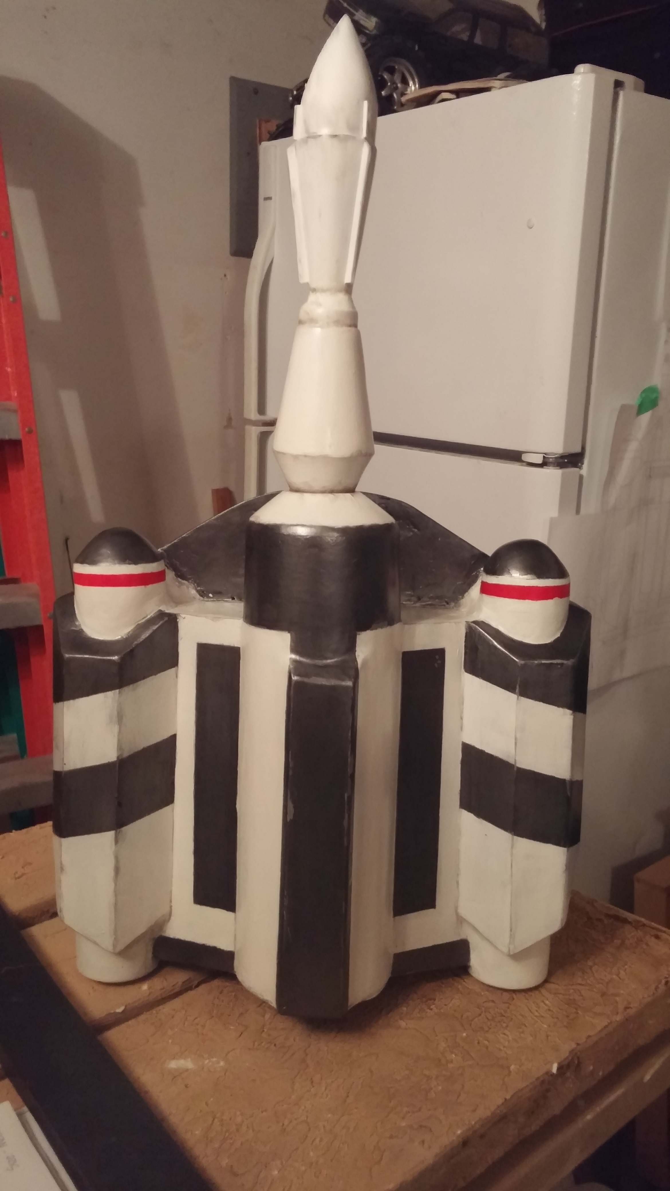

Ill keep updating my progress. Oh and this is my final first version.

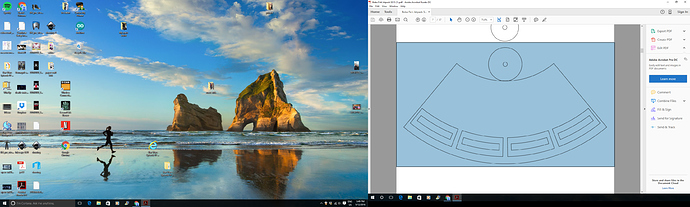

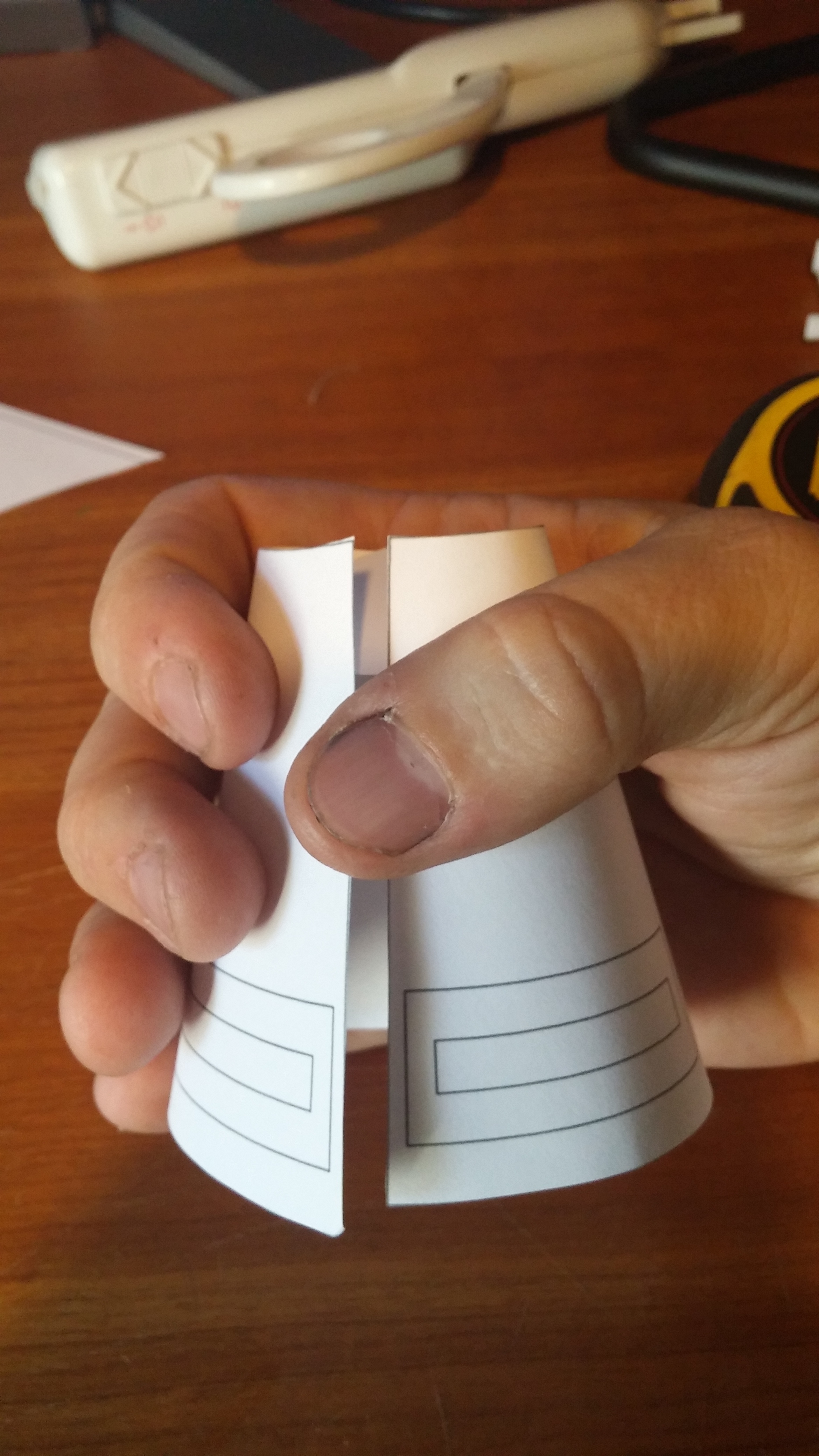

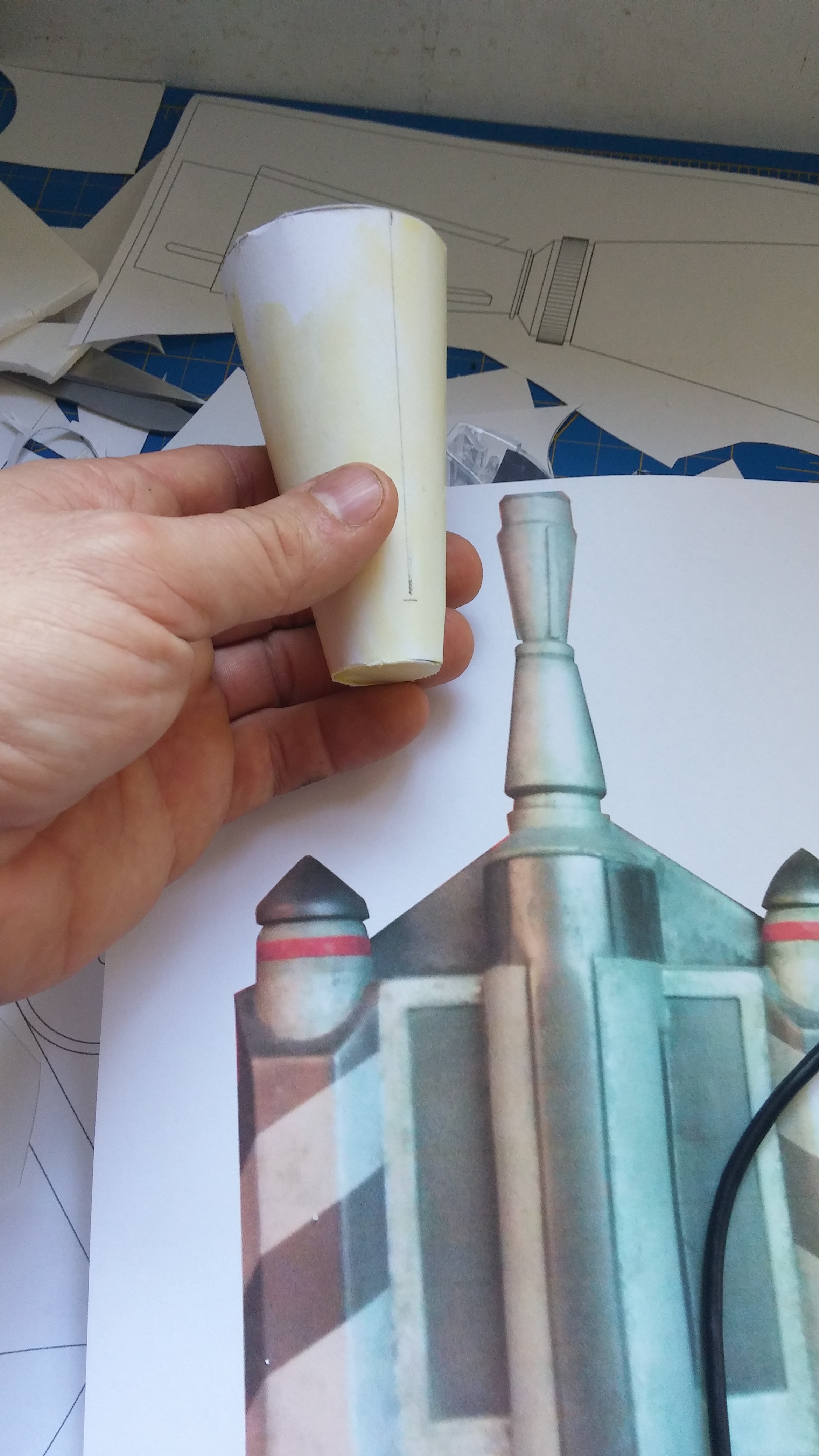

So basically the shape thats on the right screen in blue is a template for papercraft. I want to make that out of wood and be able to bend the wood just like paper. The shape in blue forms a cone when cut out and shaped.
The cone in my hand is the shape after cut out.

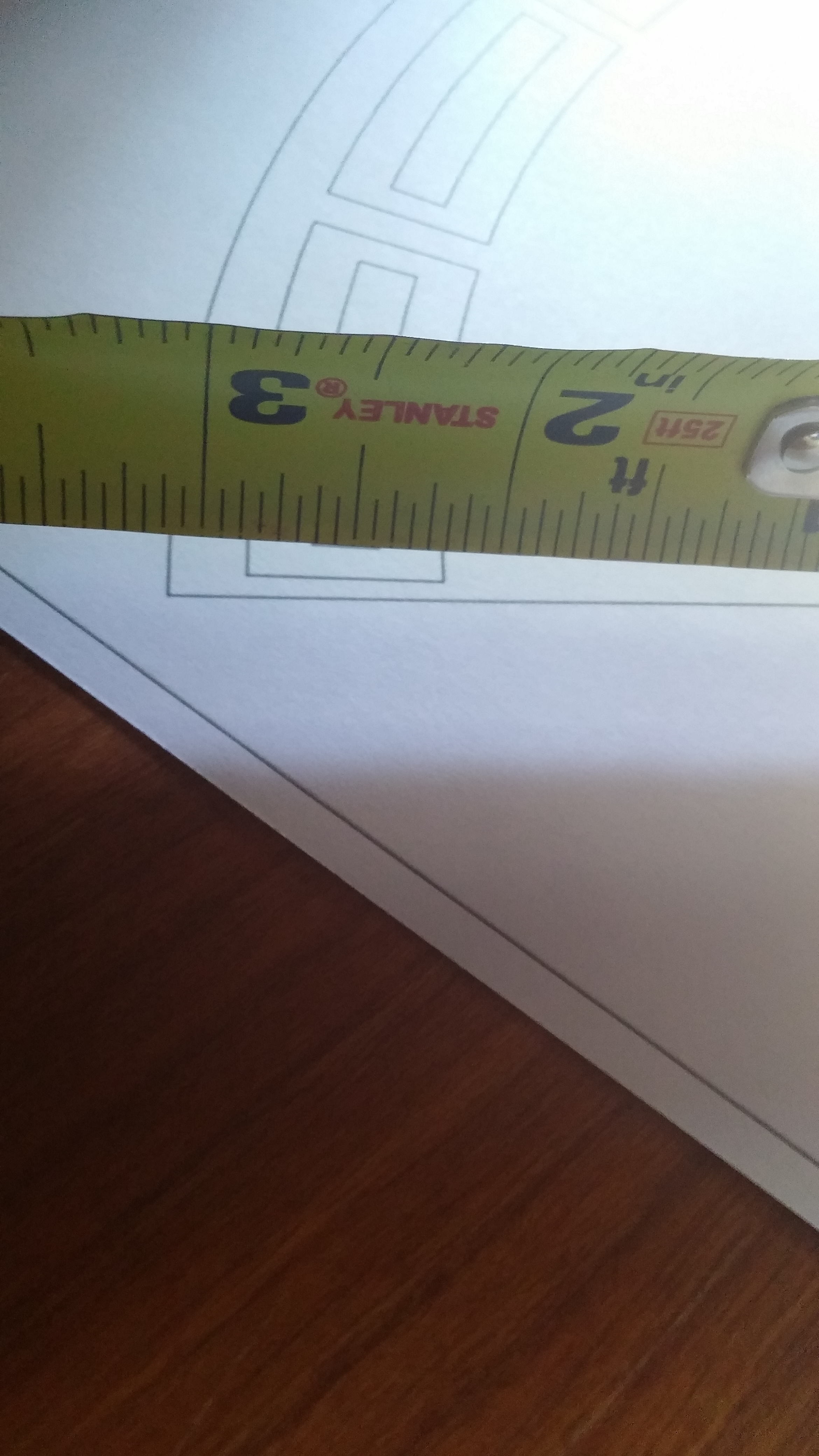

First off just want to say thanks for all the interest in my thread! So ill include some pics with dimensions.
Ok so top 2 images are just dimensions of my cone.
Second is after i cut it out, and fold it.
Again thanks for all your input!
