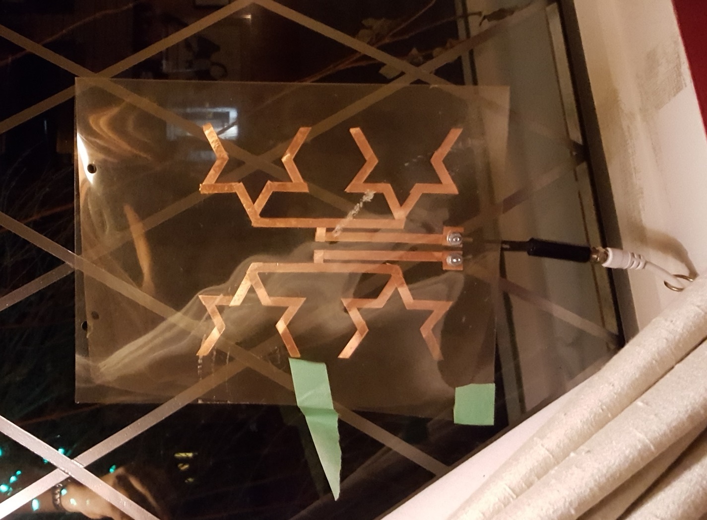

For local reception I use a homemade version of one of these mounted on a clear plastic page protector. It is hangingin my living room window and I get excellent HD video quality with all of the local stations.
http://www.leevalley.com/en/images/item/Hardware/EntertainmentCenter/88k9730s1.jpg

I made mine with self-adhesive copper foil (with conductive adhesive) mounted on a plastic page protector. I got the balun from the dollar store. If you can’t find copper foil with conductive adhesive, just use regular self-adhesive copper foil and put a drop of solder on the joints. You can get the copper foil from a stained glass supplier such as Kona Glass on Knight Street.
The green tape is just to tape one edge to the window to try and reorient it to a better angle. Ideally, where I am located, the flat face should be oriented North-South but my window points East. Nevertheless I still get stellar reception for the local channels. Not so great for the US channels because of the orientation. When oriented N-S I get KVOS and KCTS pretty good.
I am totally making one of these tomorrow.
Where are you getting the copper strips from along with the conductive
adhesive Janet?
I have some copper tape kicking around…the kind that you use for stained glass.
