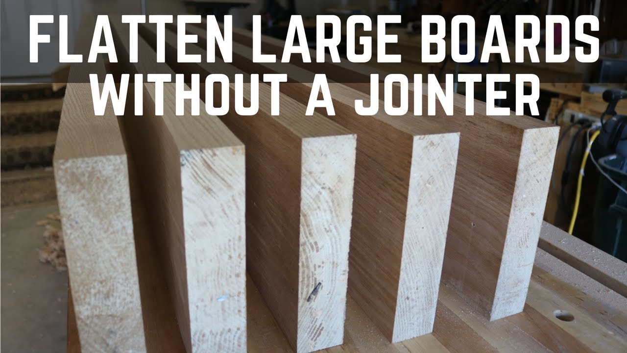

What are the dimensions of your slabs? We could do a jointer sled to use on the thickness planer then just thickness plane it
Thanks Mike. one is about 13 inches across the other is about 15 inches across, both are 65 inches long and approximately 2ish inches thick.
The tutorial you shared looks like a good way to go about it. I’ll go into hack space and measure to see if my boards will fit through the planer. Are you going to be around next week? If you’re free can you give you a crash course on using it?
