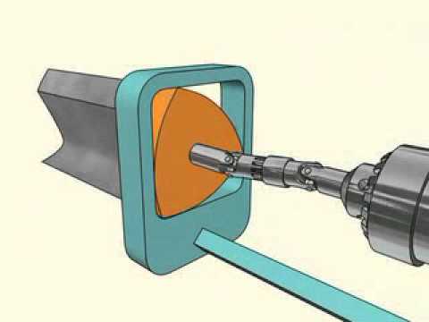

Here’s one idea I’ve come across: https://www.youtube.com/watch?v=M3Ul-s9_MA0
Let me know if any of you have any other tricks to do this.
