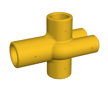

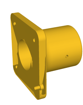

One of the things we are printing for the search and rescue medical deliver drone.
Structural joiner for motors and 40mm carbon fiber tubes cross members
This is oversized assuming a imperfect 3D print.
We are currently 3D printing this part, but given its simple form. It is probably very easy to autoclave it with fabric. And hopefully cheaper too.
