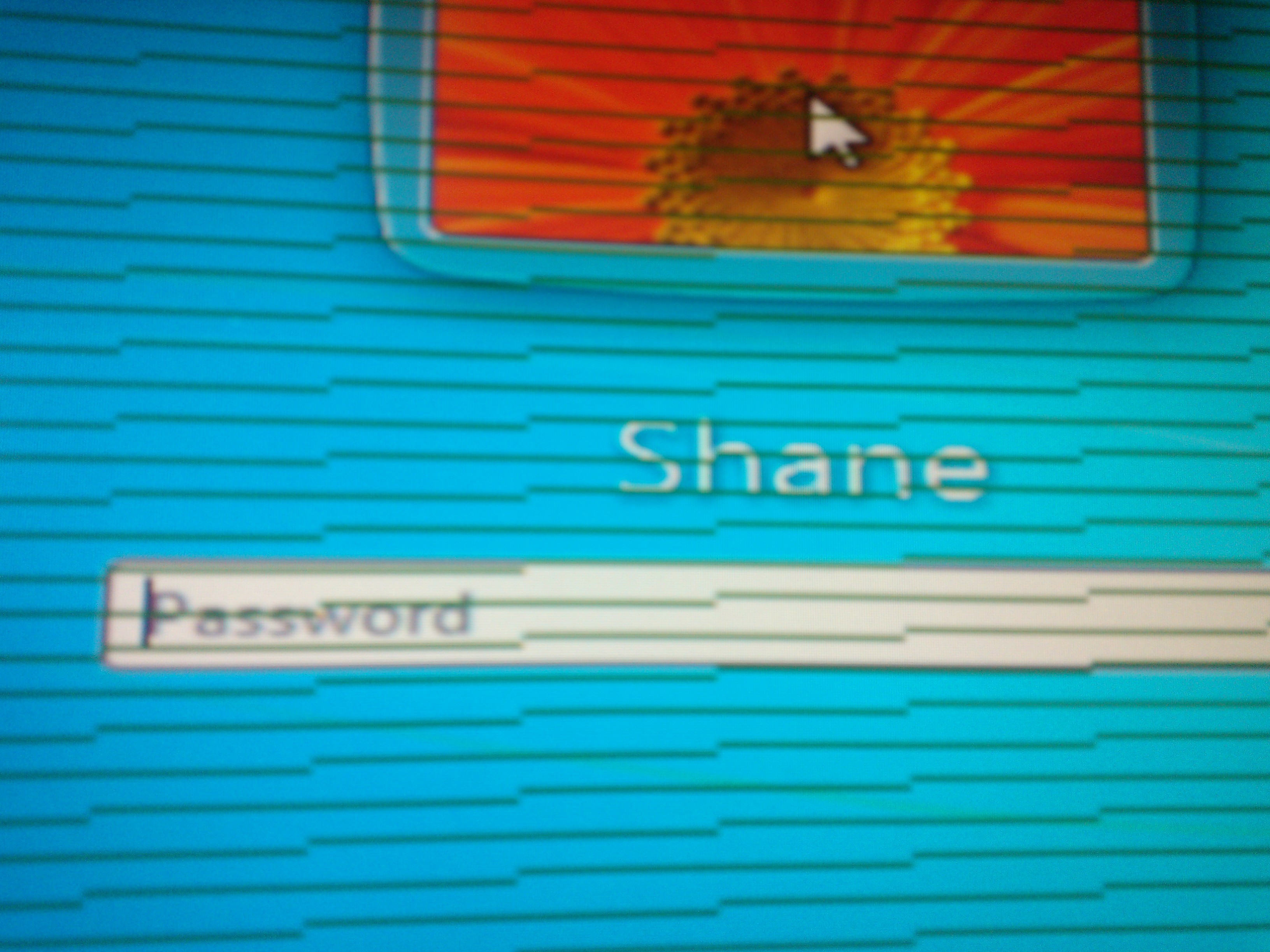

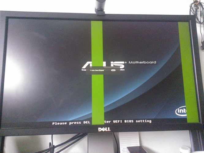

My desktop PC has an XFX Radeon 6870 that I think is failing. Last night my computer crashed, and upon restarting, I had two green vertical bars on my screen, even from time of boot. It then appeared to crash (screen black, can’t toggle keyboard lights) before getting to the lock screen.
I unplugged it and left it for the night, and tried booting it again this morning. Same problem.

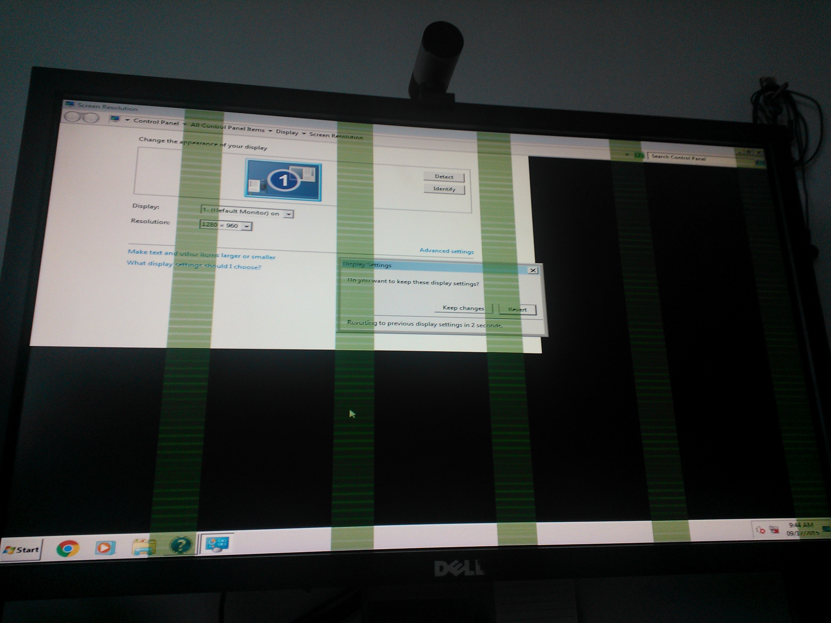

Tried booting in Safe Mode and it worked, although with horizontal green lines patterned all over the screen. This is at the default 800x600 resolution.
At 1280x960, the green lines aligned into vertical bars.

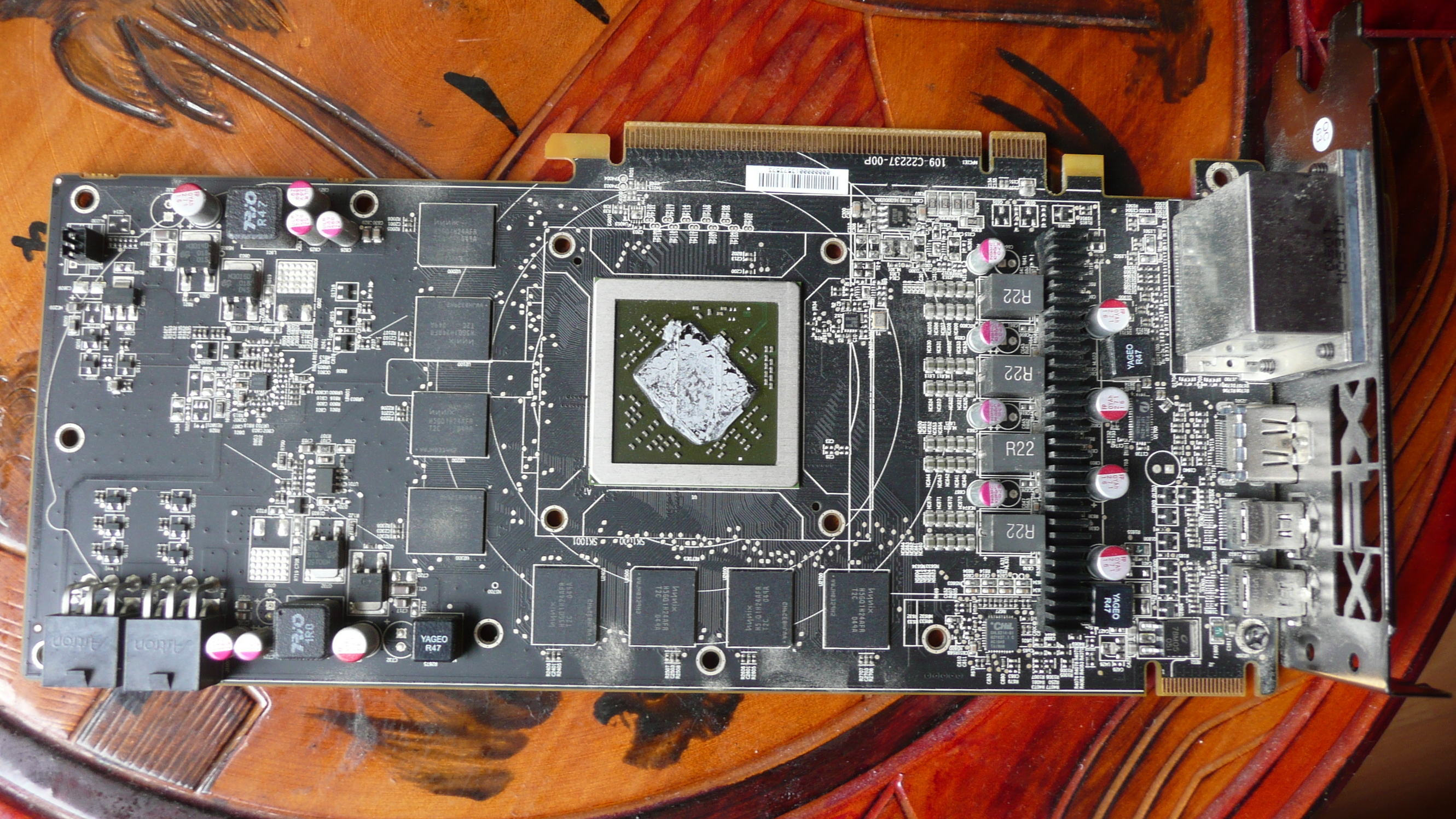

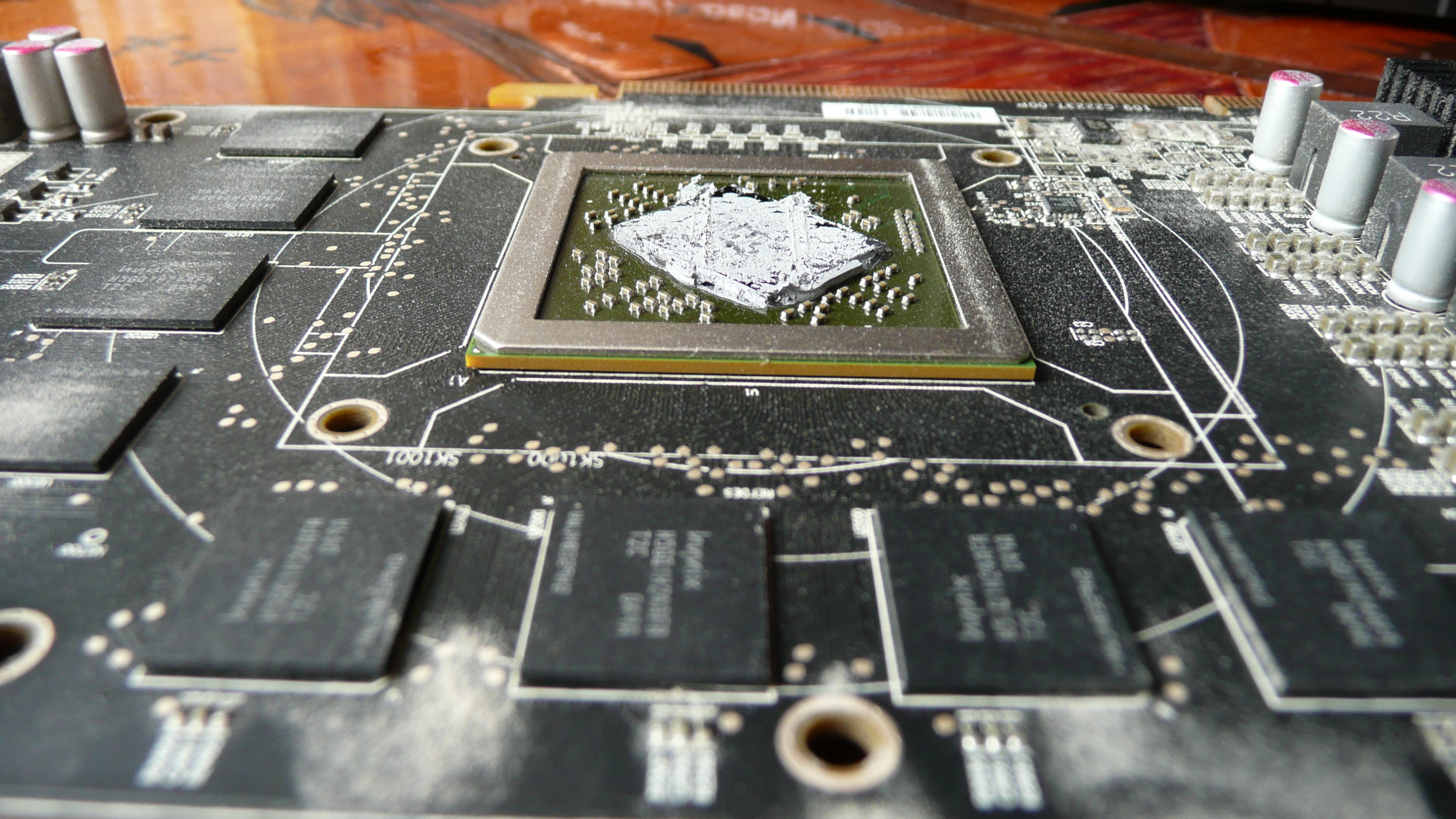

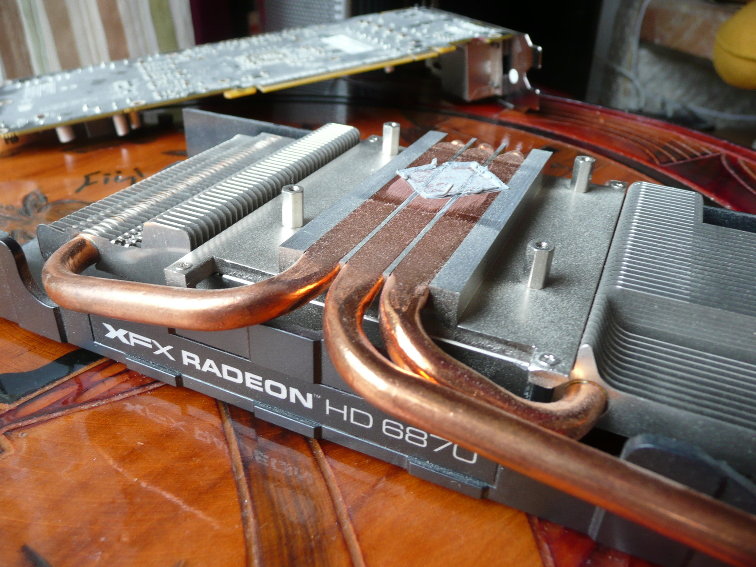

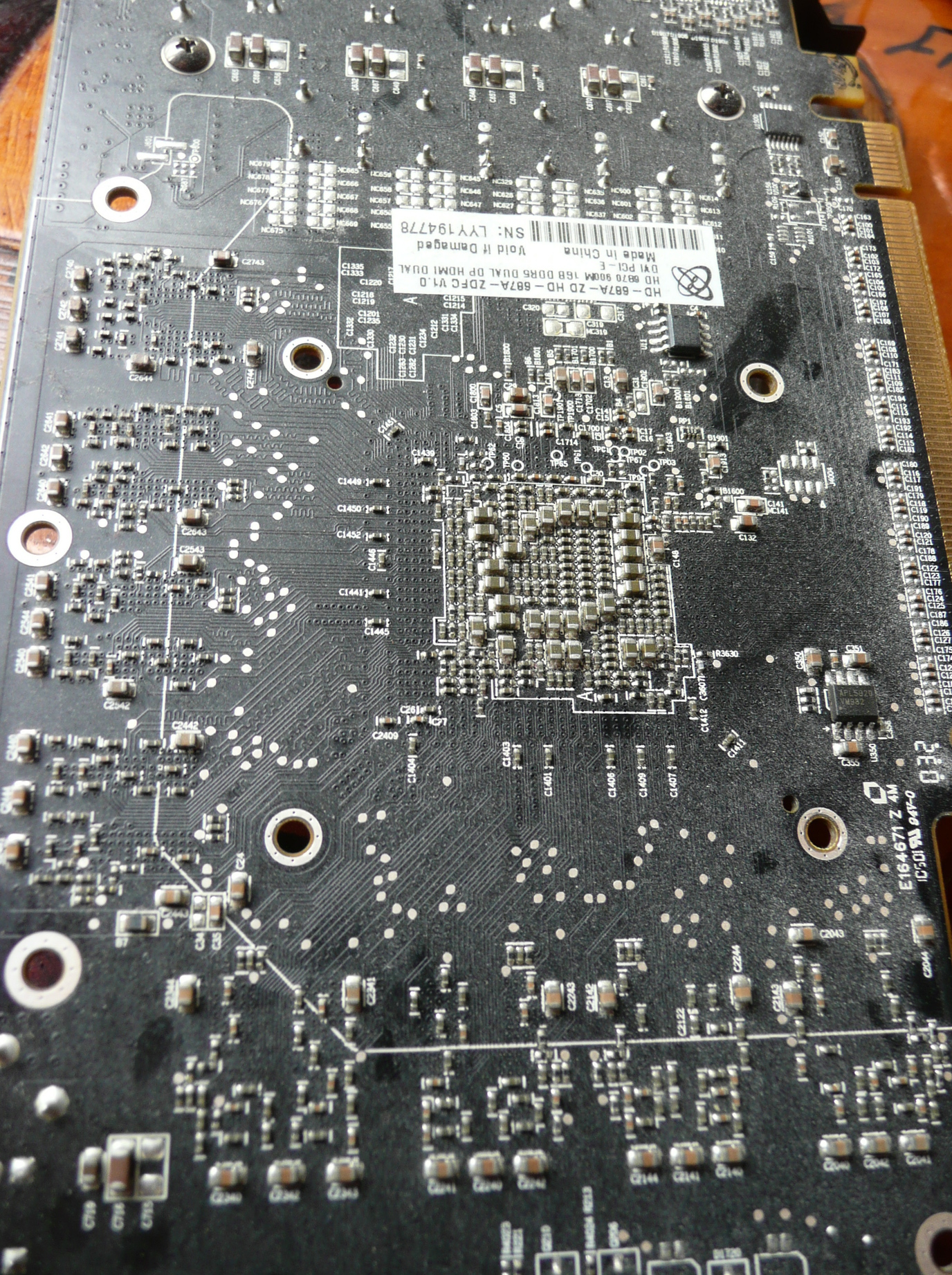

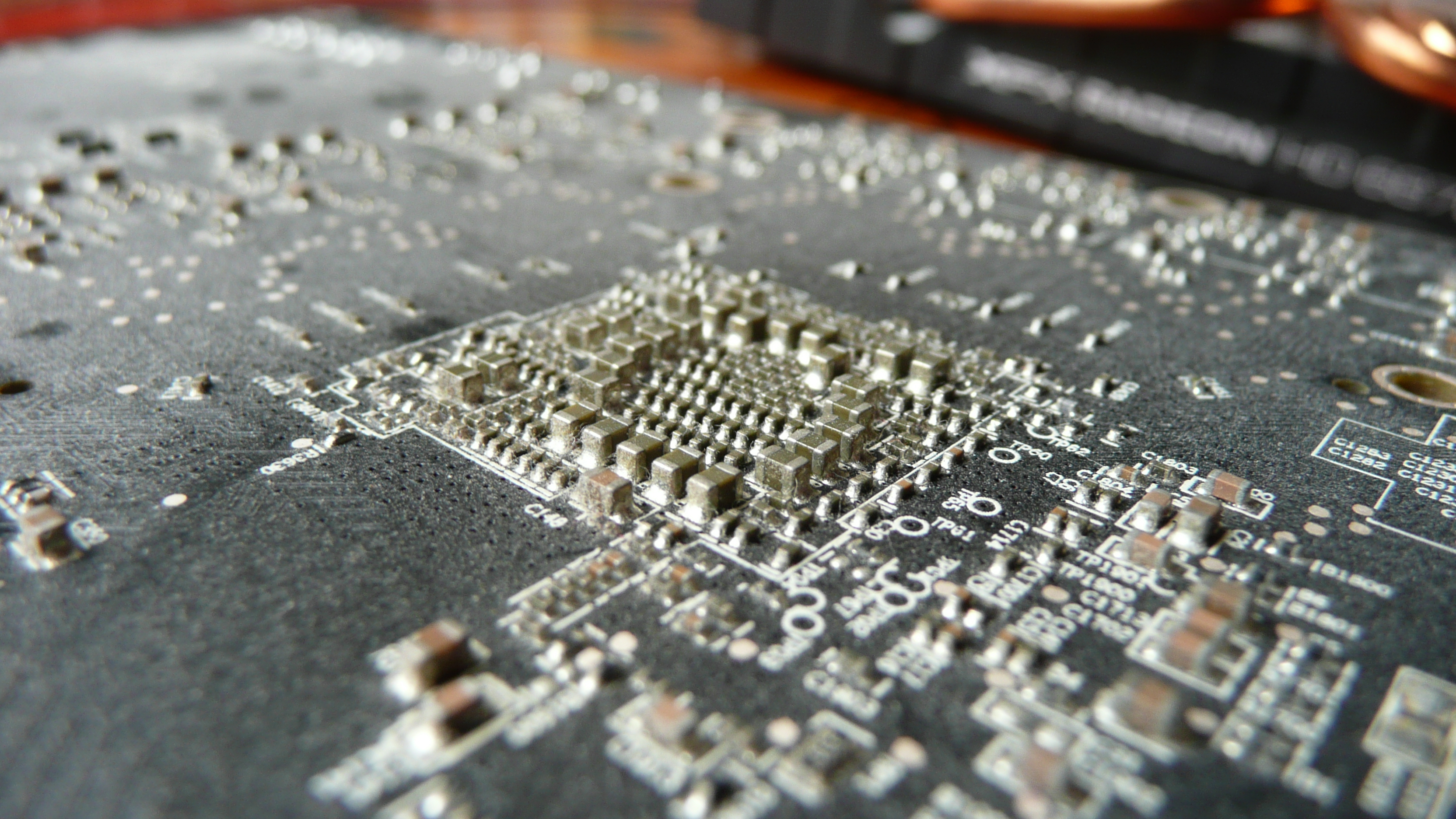

I took the heatsink and fans off of the graphics card to get a closer look. No visible damage, but here are photos for those who are interested:
First, the heatsink and fan assembly:
All the through-hole capacitors look fine.
Look at all those test points (and liberal amount of thermal paste)!
And more on the back!
And here’s a bird’s eye view of downtown Capville:
no close ups of the caps?
I didn’t think it was necessary, as they all look fine. They’re all nice cylinders with either flat or slightly concave tops. No cracks, bulges, scorch marks, or anything. Do you still want photos of them?
Also, I’m assuming you only care about the large through-hole capacitors, not the SMD ones, because including both would be ALL CAPS.
I just wanna see if I can find the problem. more pics the better.
