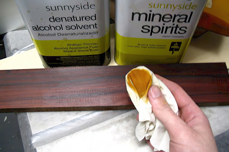

Gluing and Finishing of Oily Hardwoods
For every woodworker’s info:
Gluing Oily Tropical Hardwoods | The Wood Database.
As the article states, you may have had success gluing some of these with aliphatic glue, but that doesnt mean that it is guaranteed to have full strength every time.
And many of these oily woods can also pose a challenge for reactive finishes like polyurethane to fully cure over.
Hope this info is valuable!
