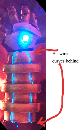

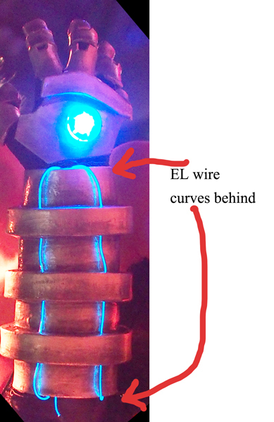

ALSO my EL wire eventually stopped working. I assume because the EL wire had to “curve” by about 160 degrees as depicted in this picture. I had to curve the EL wire back inside my gauntlet to “loop” it around:
Question: Is EL wire not able to curve like that? It worked for a day and then the light diminished, then it stopped working in total.

The curves probably did the EL wire in. You are better to keep it reasonably straight and make any curves gentle. So for this you would be better with several smaller lengths on the outside (it looks like you wrapped it around the inside and outside) Means doing soldering but would cut the length in half so you get double the run time…

In that case I’ll have to find a better way then curving the EL wire - I did indeed wrap it around the inside and outside. I couldn’t find a better way to attach my EL wire to my gauntlets and still have two lines of blue wire on my gauntlet, so I looped it.

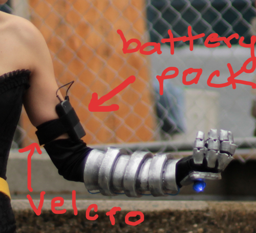

For the new design, this means I would need two separate EL wires with two separate battery sources to achieve the same look? I think I’d be ok with a smaller battery, mostly because of how exposed this big 2xAA pack looks here:

Your costume looks a bit harder cuz you probably don’t want wires across your arms. What are the gauntlets made out of? Perhaps you could carve some of the material away (on a side people don’t see as much) then glue the battery pack in and paint it up to match the rest.Least then no one would really notice the battery pack…

The two things that will destroy EL are sharp corners (it would break the phosphorus coating) and frequently bending EL (same).
I guess the sharp corners made my EL wire fail then :frowning:

I didn’t know multiple EL wires could be connected to the same source - I might just have to do that instead for the gauntlets instead. The gauntlets are made from craft foam - so I like the idea of carving a piece of it off in the back and somehow securing the battery pack to it. The battery pack would definitely be way less exposed than it currently is now…
