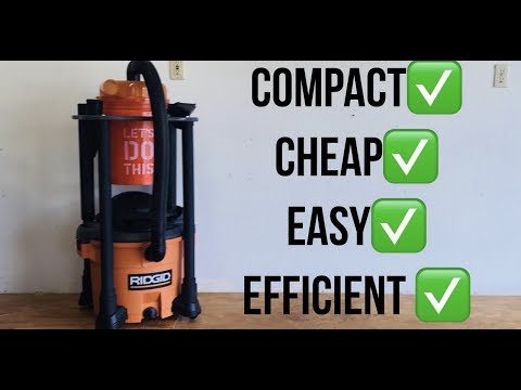

Project 1: Rolling cart + home depo make shift cyclone stand. Bounty: 30 dollars. [COMPLETED]
Remember the good ol days before our shopvac caught on fire? Yeah Pepperidge farms remembers. @MichaelG has put his shop vac on loan to the space but we now have two objects on the ground and it would be great to condense it so it’s a singular tower like it was before. All the materials you might need are in the shop so this should be an easy win for anyone who has the time to make it. Feel free to grab what you need out of the scrap bin. There’s casters floating around the space. You should not need to spend a single dime on materials on this project if you look around.
Does it have to be pretty? no. Does it have to have googley eyes… Yes. Obviously.
An example of this would be:
