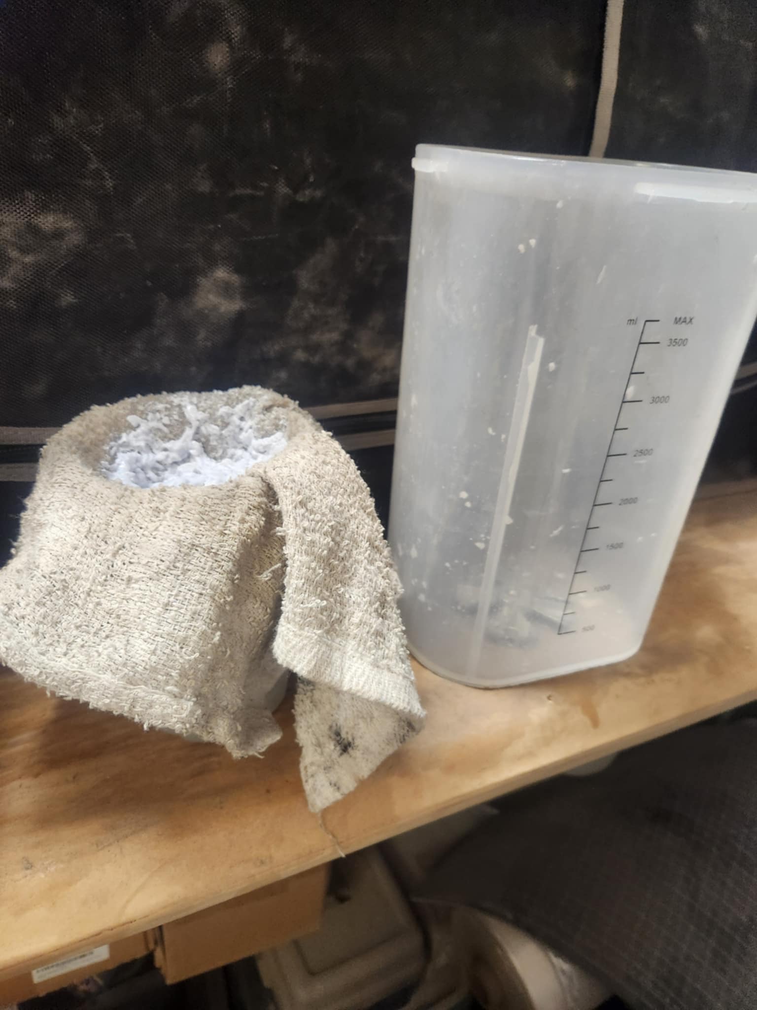

Used some of the dispensable rags and getting a little dirty to use as filters for cleaning the IPA of the cured resin in the wash - worked like a charm and made it very easy to do!

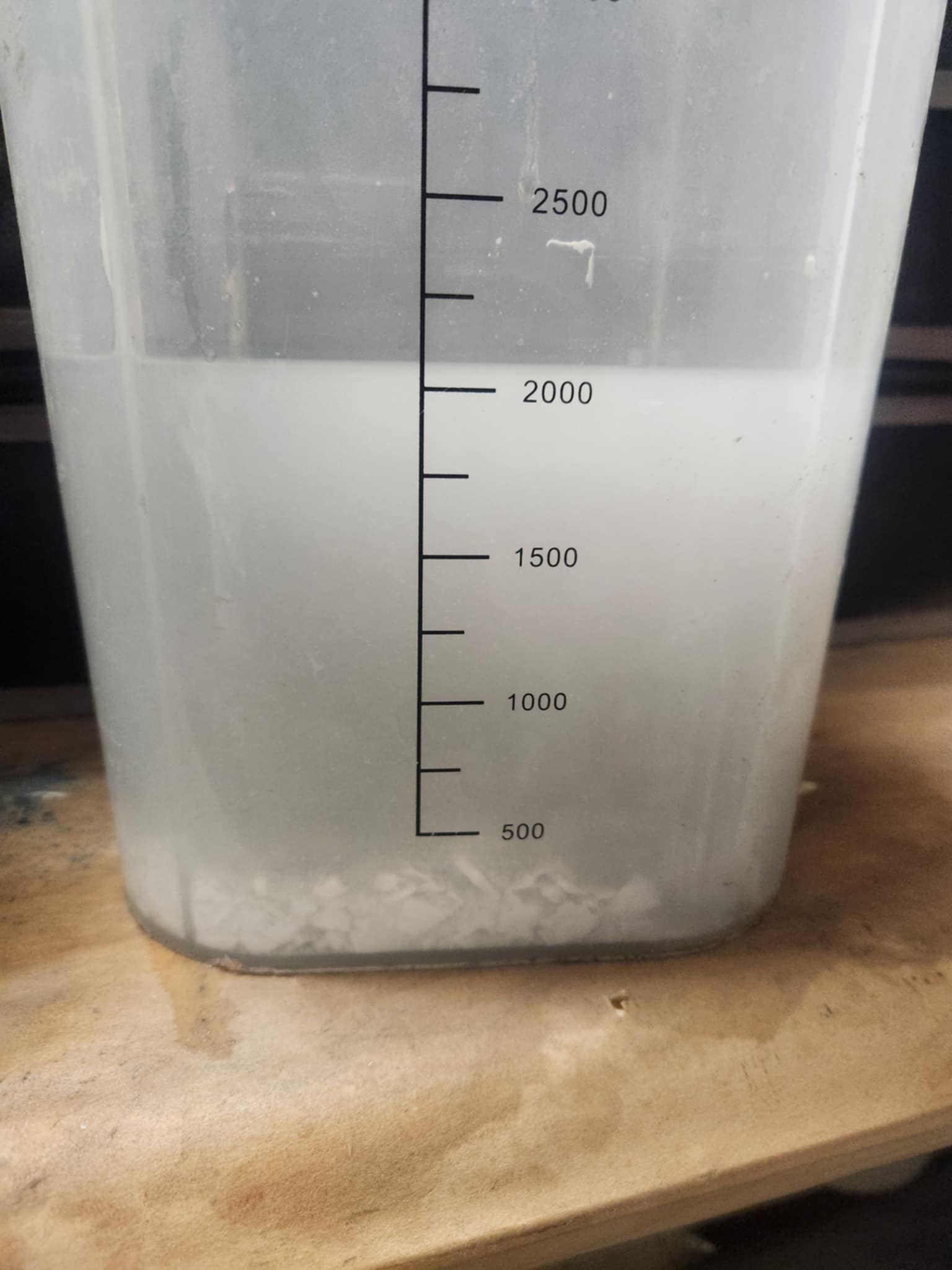

Anything thats liquid can still be used to wash the resin prints - although to be fair, the stuff thats in there currently should probably be replaced since its so murky you can’t see through it anymore.
The white stuff means that the UV light was used when the wash bucket and dirty IPA was in it, which isn’t the end of the world, but does mean it creates this white stuff that then swirls around and gets caught on/in the resin prints in it! Better to have it strained out.
