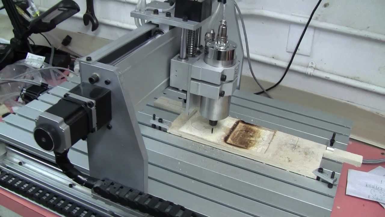

I’ve heard lots of good reports about these cheap cnc machines. Out of the box they need a PC with a real parallel port but there are lots of controller hacks on the market. These things are brutally solid those uprights look something like 5/8" thick, it weights a shit ton - hence it is ideal to ship in a container. The model number reflects the table size, there is also a 3040 etc. You can also upgrade the 300W spindle to 800W water cooled but is expensive (would make a nice upgrade at a later date once you’ve learnt the thing).
The 3020Z ball screw version is recommended - approx $CA640 before any duties and shipping.

Didn’t have a great experience today. The mechanicals are nice but the controller is junk - it smoked the parallel port in the (junk) pc we are using. There was already a plan to upgrade to a gcode usb board, looks like this is an essentiall step. It might be possible to buy without the electronics eg. http://item.taobao.com/item.htm?spm=a1z10.3-c.w4002-2964122557.16.p0OPBc&id=21731515565
If you could get it without the electronics but with the motors (and it looks like they have encoders on the steppers) we could use a Smoothie Board or other 3rd party controller…
