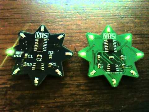

@TomKeddie any idea why one of my stars has a different frequency (8.9 Hz)?
I took a very close look under microscope and the one on the right has no visible faults. There could be a short under one of the caps or resistors, but when I shorted R2 on the working star (which seems to be the only element that can increase frequency), it wasn’t going as fast as the one on the right. (normal mode is 1.2Hz, shorting R2 got me 2.5Hz)
My best guess is perhaps one of the components is faulty.
I believe you got one of the coveted high speed kits…
I think I changed the component values and didn’t update the doco. Can I leave some other caps to try in the dropbox? Are you ok desoldering the wrong ones and resoldering them? @Janet you miht have the wrong parts too.
Thanks Tom! I have 3 kits with green boards and 2 blue. What caps should I have?
Yeah that wouldn’t be a problem. Thanks Tom!
@Gonazar I left some caps for you in the dropbox at vhs. Let me know if they work and I’ll give some to @Janet too.

@Janet I’ve verified the replacement caps, will leave a strip for you in the dropbox over the next few days.
Thanks Tom!
Got mine and replaced the caps. Works great! Thanks Tom!
