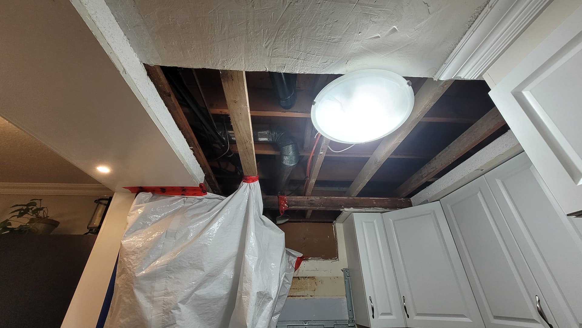

I had a water incident at my place, resulting in my bathtub on second floor draining into my kitchen on the first floor.
Plumbing has been fixed and abatement done, so moving now into the process of putting things back together. Insurnace is covering most, but not one of the corner cabinets.

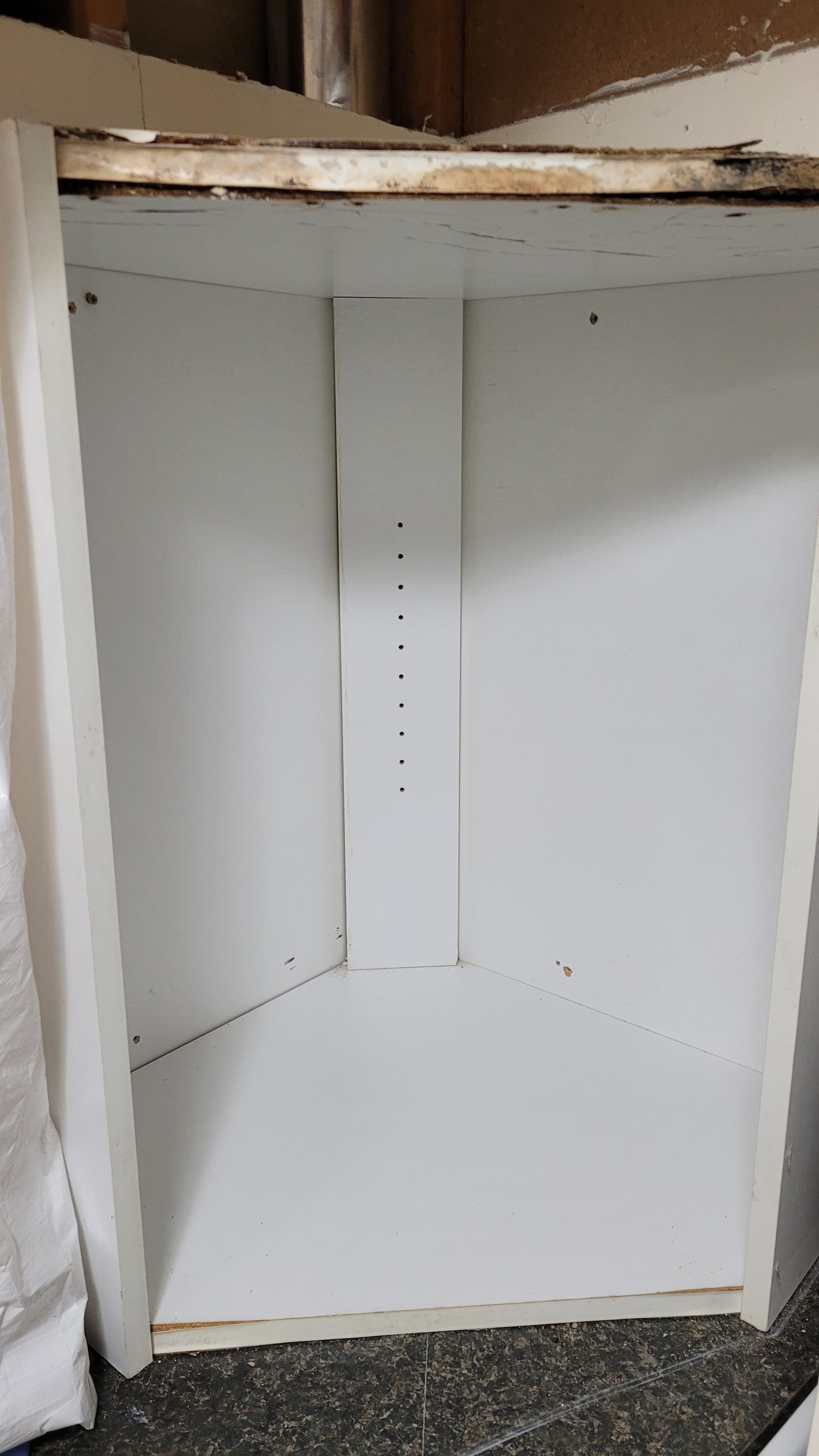

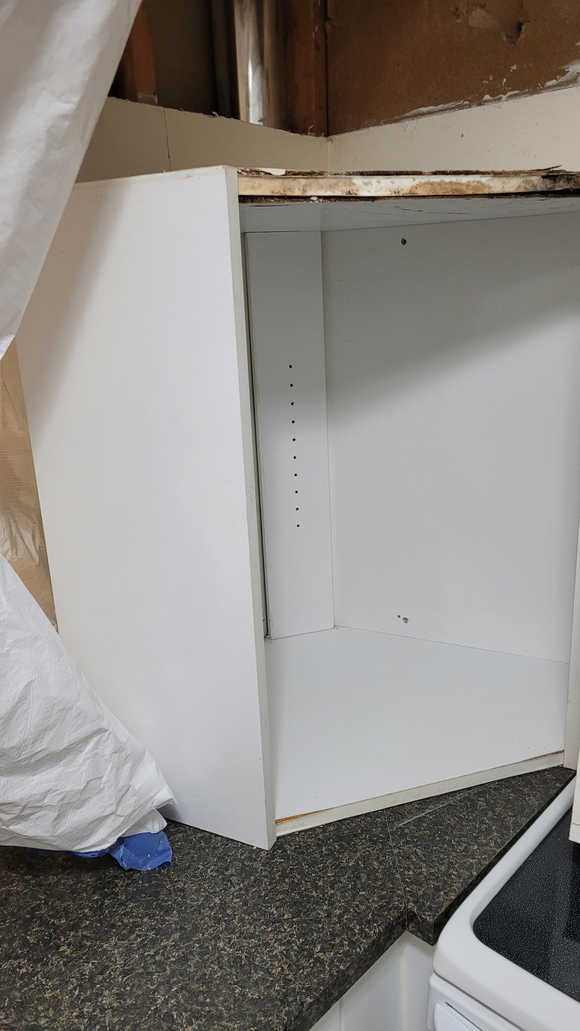

The corner cabinet quote is $2,500, and I still have the door for it. I have the damaged cabinet still, so my thought is to trace the parts and cut myself? But I have never build a cabinet before (particle board with the white wrap exterior), so not sure about joining corners etc. It is a pentagon shape.
Any tips or ideas on this? Or is this way harder than I think and $2500 is reasonable?

Sligh difference in depth ( mine are 11 3/4, ikea 14 1/2) but height is exactly correct. This is giving credence to “there is a better path” here for me here. Can particle board be cut on the table saw, or does that trigger a stopsaw, and maybe trim to size.
