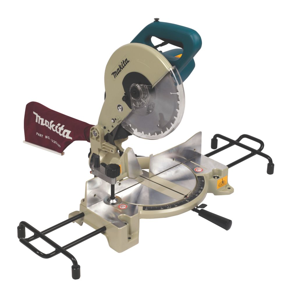

Unfortunately the Makita Miter Saw is broken.
image https://media.screwfix.com/is/image//ae235?src=ae235/22723_P&$prodImageMedium$
The retracting guard is jammed and will not move properly out of the way of cuts.
In my opinion it’s not safe to use and needs to be repaired or replaced.

Thanks for bringing this up. I have had this guard apart to diagnose/cobble back together a couple of times in the past month or so. Initially I had thought it was fixed, but seems to reoccur. From what I can tell, it has been “repaired” at some point in its life and no longer can be used as intended. There are some instructions online on how it should go together: https://youtu.be/bOuOSkxyICo

Likewise, it was jammed on me once, some disassembly/reassembly seemed to solve the issue temporarily, but part of the mechanism feels like it’s on its last legs.

He discovered a snapped off pin which acts as a cam for the guard mechanism:
Unfortunately the Makita repair centres are closed over the weekend, and only opened between 8:00 am to 4:00 pm on weekdays.
The model we have is the LS 1013; it has been discontinued, but the parts may still be available.
Is anyone available on weekdays to reach out to the Makita service centres and see if they have the part?
I can’t find a link to the pin itself that connects to the link plate (shown in the top photo, sheared off)
The related parts in the diagram are #19, #20, #21:

I have phoned the Burnaby Makita Factory Service Center; they are ordering the parts and should be able to get them around Thursday.

I checked what we have and it looks right. I called again today. The final part (ring 6) is being shipped by ground from Quebec. Makita didn’t know when it would arrive, but would keep an eye out for it.
