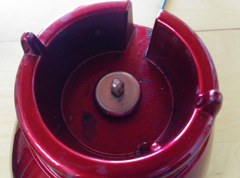

My roommate’s blender (Oster 6844) has stripped the threads that connected the motor shaft to the coupler. Buying a new coupler is cheap and possible, but the threads have been stripped off of both the coupler and the motor shaft.
Coupler and stud as you’d normally see it:

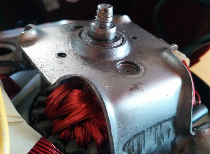

Stripped shaft threads:

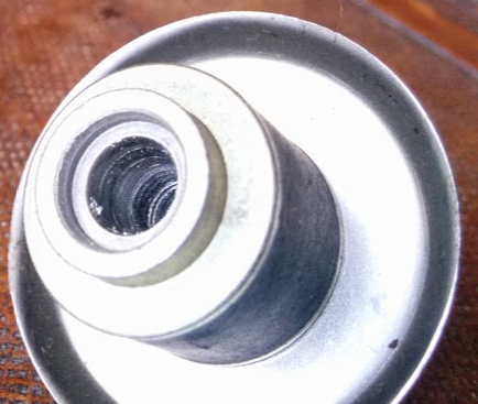

Stripped coupler threads:
Any google search results about stripped threads/couplers are actually referring to the square stud, so I don’t know if it’s possible to fix this. Any ideas? There’s a fair bit of play since both sets of threads are pretty much gone, so I don’t have a lot of confidence in, say, using epoxy to fasten it back on.
Drill a hole through both and use a spring pin? We have a decent spring pin selection (a kit) in the space IIRC.
The stripped motor shaft is 4.5mm diameter at its thinnest and 5mm where the threads still sort of exist. The shoulder (still part of the shaft) is 8mm dia, but has very little overlap with the coupler. I’m not sure if there’s enough material there to be drilling a hole through it. Also, the coupler has a large plastic part that I think is meant to reduce shock to the motor, and I suspect it might not like to be drilled through.
I say this not fully knowing how to use it, but I believe we have a tap and die set, would this be an appropriate use?
You might be able to use a small bit of tubing that is threaded to your new threads to fill the gap.
Yeah, I’ve thought about rethreading the shaft, but I’m afraid it might be too thin to thread. I’m assuming there’s a fair bit of strain on this area, given that the original threads wore off.

I eventually decided to glue the coupler back onto the blender with JB Weld. Despite my best efforts, it wasn’t centered enough and the eccentric motion created too much resistance. But after an hour or so of filing (with a diamond file, because the coupler is hardened) the eccentric motion was reduced enough that it is working again. So that’s good.
