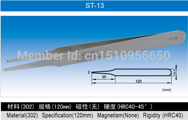

Tweezers
I prefer blunt fronted tweezers as they have a larger flat surface area (the fine tweezers often have rounded tips making picking up square smd parts difficult).
Aliexpress I have a bunch of these for 50c each.

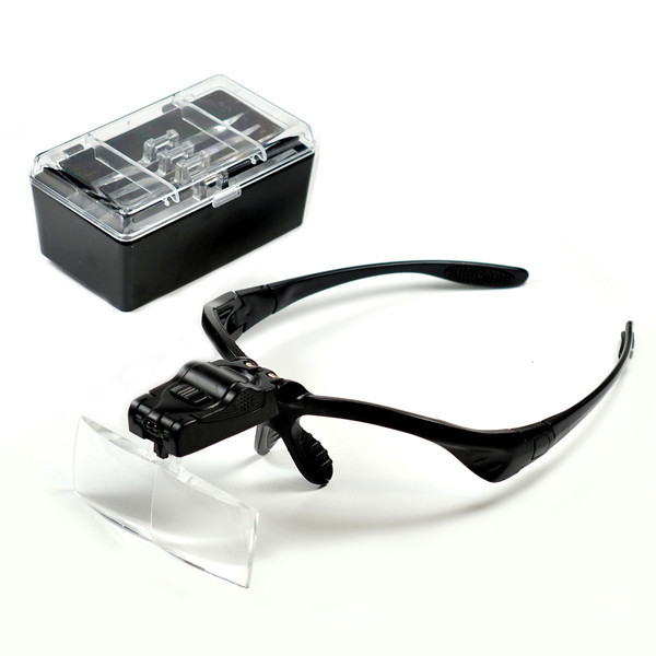

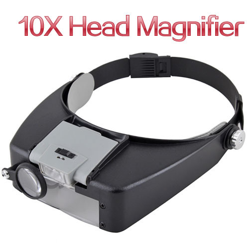

Magnifiers
Aliexpress Amazon
Aliexpress

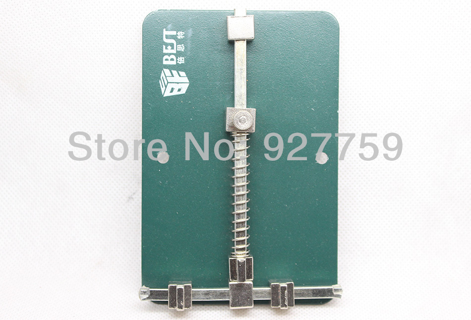

PCB Holder
The holders are great but are only suitable for small pcbs up to about 6cm. The tape is handy for boards that don’t fit or a budget alternative.
Aliexpress (I still have a few for $CA5).

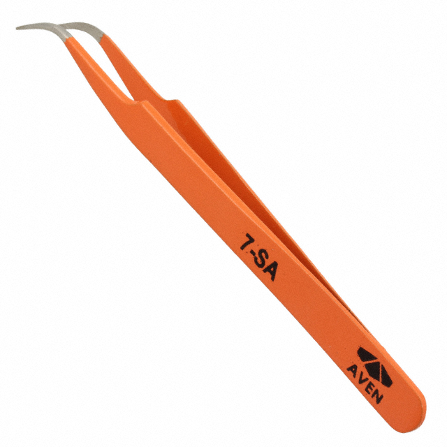

Tweezers
Good tweezers are not that expensive on DigiKey, I’d recommend just tossing them into a parts order instead of going to the trouble of ordering unknown quality stuff from China. I like these, and unlike most, prefer the curved style for SMD work. The cheaper EROP7SA is also good quality but the painted one from Aven is easier to find on the bench and I find the profile more pleasing. Obviously straight and blunt versions are available also.

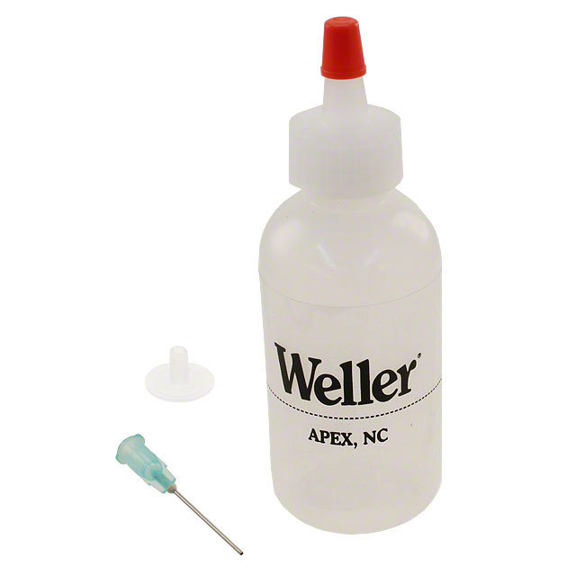

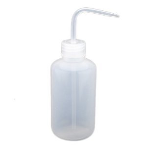

Tom, how could you forget! You’ll need flux. I like using this type of squeeze bottle with standard rosin liquid flux:
The flux, as far as I can tell, can’t be shipped to Canada by any of the regular suppliers as they don’t list it in bulk (non-pen) format. It can be had locally or probably gotten from eBay/AliExpress/DX. I use the stuff from MG. Flux pens are easy to get but I prefer the squeeze bottle. On more than one occasion I’ve been frustrated by the dry tip of my flux pen and on pressing the tip to dispense more, flooded my bench with sticky flux…
99% isopropyl, perhaps also in a squeeze bottle like this, is nice to have for cleanup:

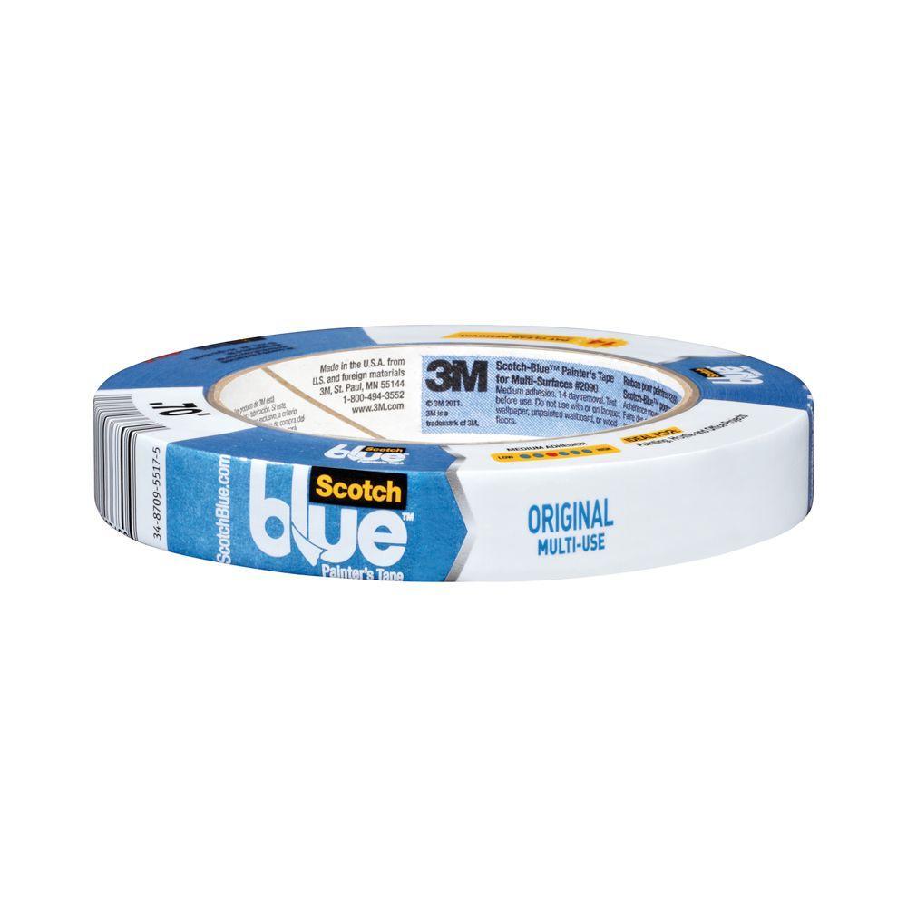

Works well for beginners to hold pcbs in place while they assemble them.
Transparent Tape versus Transparent Tap
@ktims thanks for sharing, you have a good point on the tweezers (although I’ve had no issues with those).
Indeed, it was 4am. I try to get beginners to avoid adding flux, it gets messy quickly. If you get it right first time there is enough flux in the solder to get you by with less mess. I’ve definitely had issues with people obscuring solder bridges with layers of flux.

ok, I think typos are expected from me, sorry but a transparent tap is not
much use for soldering.
When I am doing rework, I use transparent tape to hold the pcb to a larger
piece of thick card stock. I found this simple approach works well with
double sided boards.

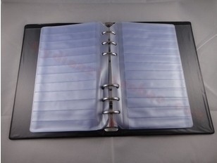

Forgot to add these. You can buy them full, I tend to buy them empty. Every time I order parts I round up the order to 100 and store the leftovers for next time. You can start with one, I have at least 6 of them (resistors and capacitors in 1206/0805 and 0603 sizes). You could also stock them from the vhs smd parts (in cases where there are 1000s of parts we will never use).
Adafruit has wider refills that are useful for semiconductors here
Aliexpress
