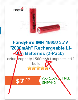

[quote=“alexg, post:1, topic:3909”]
It seems oddly misleading to spec a battery’s capacity at 12000mah when they know that it can only deliver a charge of 7992mah?[/quote]
Yeah, unfortunately. Pretty much every Chinese manufacturer does this, especially on aliexpress.
It’s one of the reasons why I like FastTech.com, cause they will actually test the batteries and post the actual measured capacity.
https://www.fasttech.com/category/1420/batteries/-/p/2?f=-
