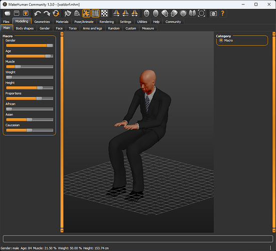

Heads are no good without a body so I went down a bunch of different tool chains before settling on the following. MakeHuman → Blender → Rhino 8 → Meshmixer → Orca Slicer → Bambu p1p with 0.2mm nozzle->prime and paint. Bear in mind, I have no idea what I am doing when it comes to animation, posing, rigging etc. so my toolchain might be considered madness.
  1. MakeHuman - Good at getting a basic human figure that can have clothes. Can export a fully rigged model (ie with posable bones and such) directly into Blender via a non intuitive combination of a blender plugin and a socket feature in the program.
