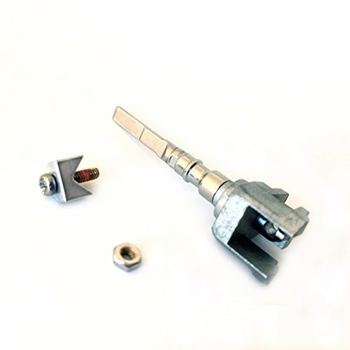

I’m trying to fix my sonicare toothbrush rather than landfilling it. This is the part that I need.
This is the metal bit that sticks out the top (that the brush head slots on to). The part isn’t available but if I could harvest the part from a dead toothbrush…that would be awesome. :slight_smile:

And…my toothbrush is fixed thanks to a spare part from @rsim’s stash of dead sonicares. Very easy to replace so I saved cash and kept it out of the landfill. Woot!
Time spent on repair - 5 minutes
Money saved (cost of new brush) - $80
What I learned:
  • rechargeable battery inside should be replaceable (often it’s glued it…but not heavily)
  • the metal brush shaft is a very common break (this was my problem)
  • board is well made and well-soldered by the looks of things
  • no parts to buy online, you need another dead sonicare (people often toss them with the battery stops charging)
  • don’t drop the toothbrush!
Part that sheared off looks similar to this (photo from instrucatables)

Dang! I dropped mine and broke the same part…does anyone else have a spare one of these?

Hey Noel! Sorry to hear your sonicare also broke. I find it amazing that this part fails so often but then again I guess us all throwing our sonicares to the ground doesn’t help. lol. I know you can’t buy the part as I’m sure you’ve realized. I have seen a few sonicares show up on craigslist for parts. People seem to chuck them when the battery dies, not realizing that you can replace the battery.
Hopefully someone here will have a dead spare or you find one elsewhere.
Just had to fix this toothbrush again - just tightening the screw. Time for some locktite. I did almost chuck it but it works fine now. I just really hate the idea of junking this thing.
Screw loosened again so I used nail varnish cause we didn’t have any blue loctite. Works perfectly now. These things seem to have a bit of a design flaw in terms of the head breaking or the screw loosening.
