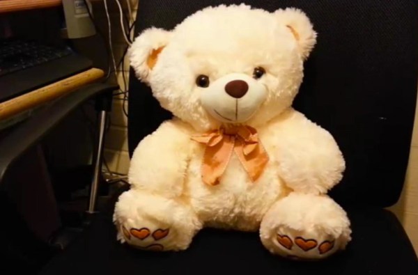

OK check this out. It’s a teddy bear where a simple servo controlled skeleton has been implanted.
The cool thing is that it can be puppeteered via a Kinnect.

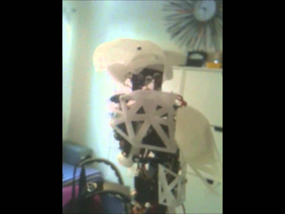

Here’s another cool project although advanced.
