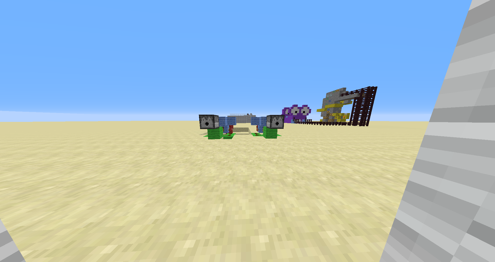

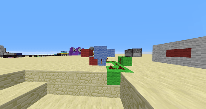

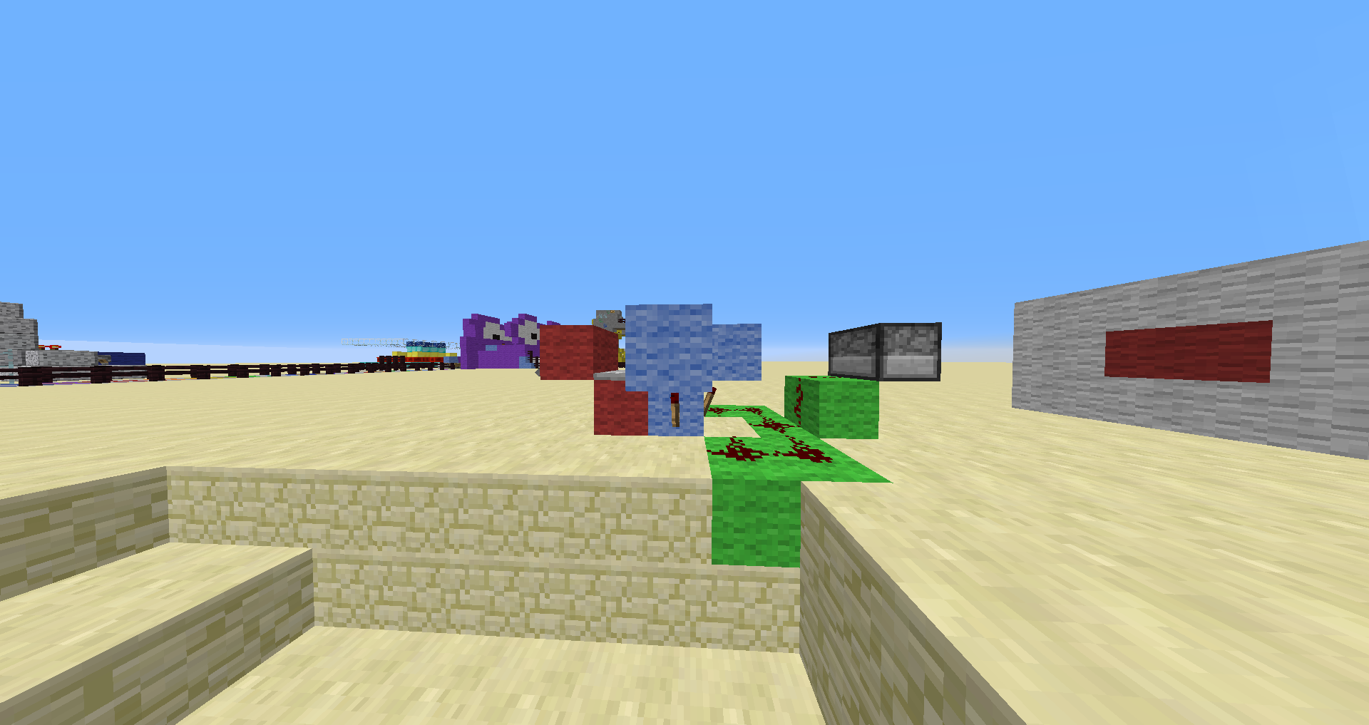

This is my favourite:
You can adjust the pulse length with the repeaters by the piston and you can adjust the repeat rate with the repeaters on the other end. Note that you can also add lots more repeaters onto that end to make it much slower.

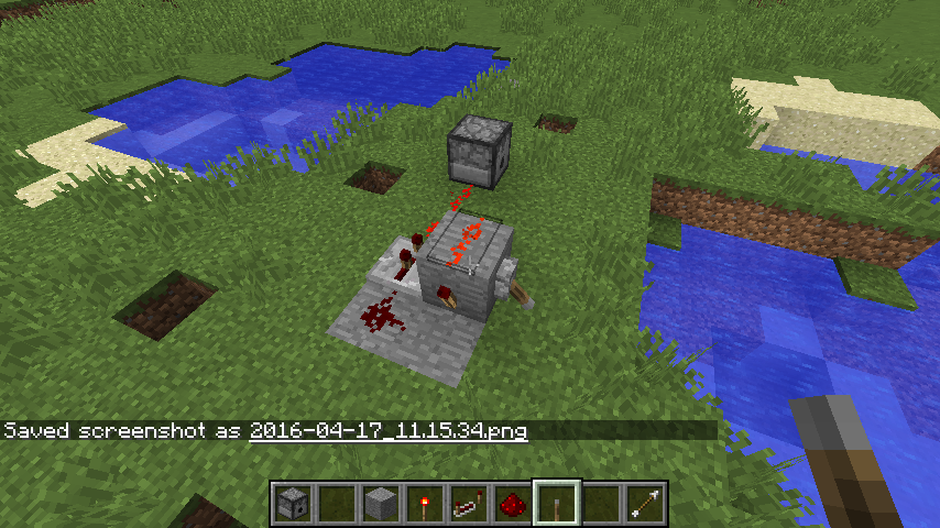

Make a simple 1 block high clock and put a toggle on the block. When the toggle is on the clock will stop because the toggle turns off the redstone torch. Invert the output if you don’t want it to be high while off (not toggling). For a dispenser block though that doesn’t matter if it remains high or low it only shots when it goes from low to high.

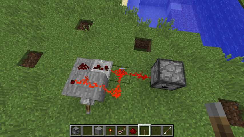

According to my son:
"This is just another variation of the above solutions. This one involves a different rapid firing system that is a little faster than the repeater clock but not adjustable. This is a good design to fit onto a wall but is a little bigger than @laftho’s design. Included are a few images of a redstone torch rapid fire system and a save file of this world (Look for the red beacon).
Use one on left
Use one on left
Save file: Unzip and drag into your save folder in the .mincraft folder (Look online for a tutorial}
